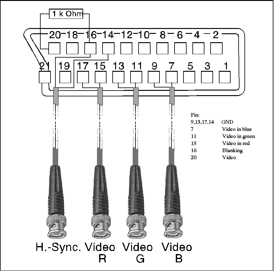

    I made this SCART<=>BNC cable using this diagram:
    but not sure that is correct. Should be CVBS connected to pin no. 19 or 20?
    19 is composit video output
    20 is composit video input
    Is it correct?

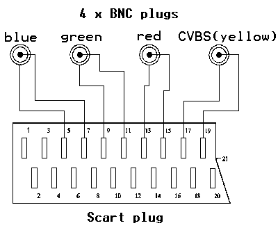

    Maybe this diagram is correct:
    I'm a little bit confused :/
  5. citrus3000psi
    Nov 8, 2013
    1,051
    418
    Composite/sync goes to pin 20. This is how I have my cable wired.
  6. M54B25
    M54B25 Spirited Member
    Mar 17, 2014
    151
    22
    First diagram is good but need to rewire this pin 19 to pin 20? No resistor no caps needed?

  8. M54B25
    Mar 17, 2014
    151
    22
    Ok, I've rewired pin no. 19 to pin no.20 and it works like a charm :)
