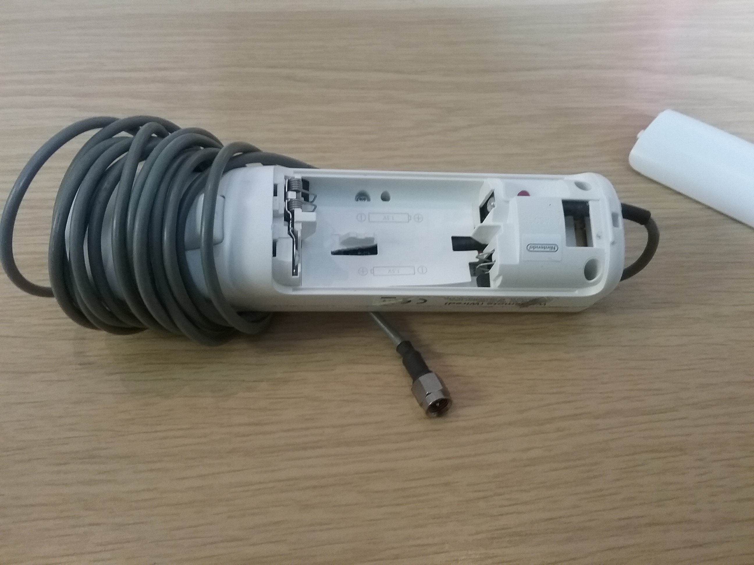

    I have found this amongst a clearance and wondered can these be used alongside regular wiis or can they be used only with development kits? Any help appreciated. Thanks in advance. 1463573061147-262442692.jpg 1463573090085161842998.jpg

    They were either used on wireless Wii NDEVs, or RVT-H/RVT-R units. I can't quite remember which, but it's definitely a dev controller.

    A said by DeChief, there where used with NDEV units. The RVT-H and RVT-R unit I have have wireless controllers.
    You can't use it with regular Wiis.

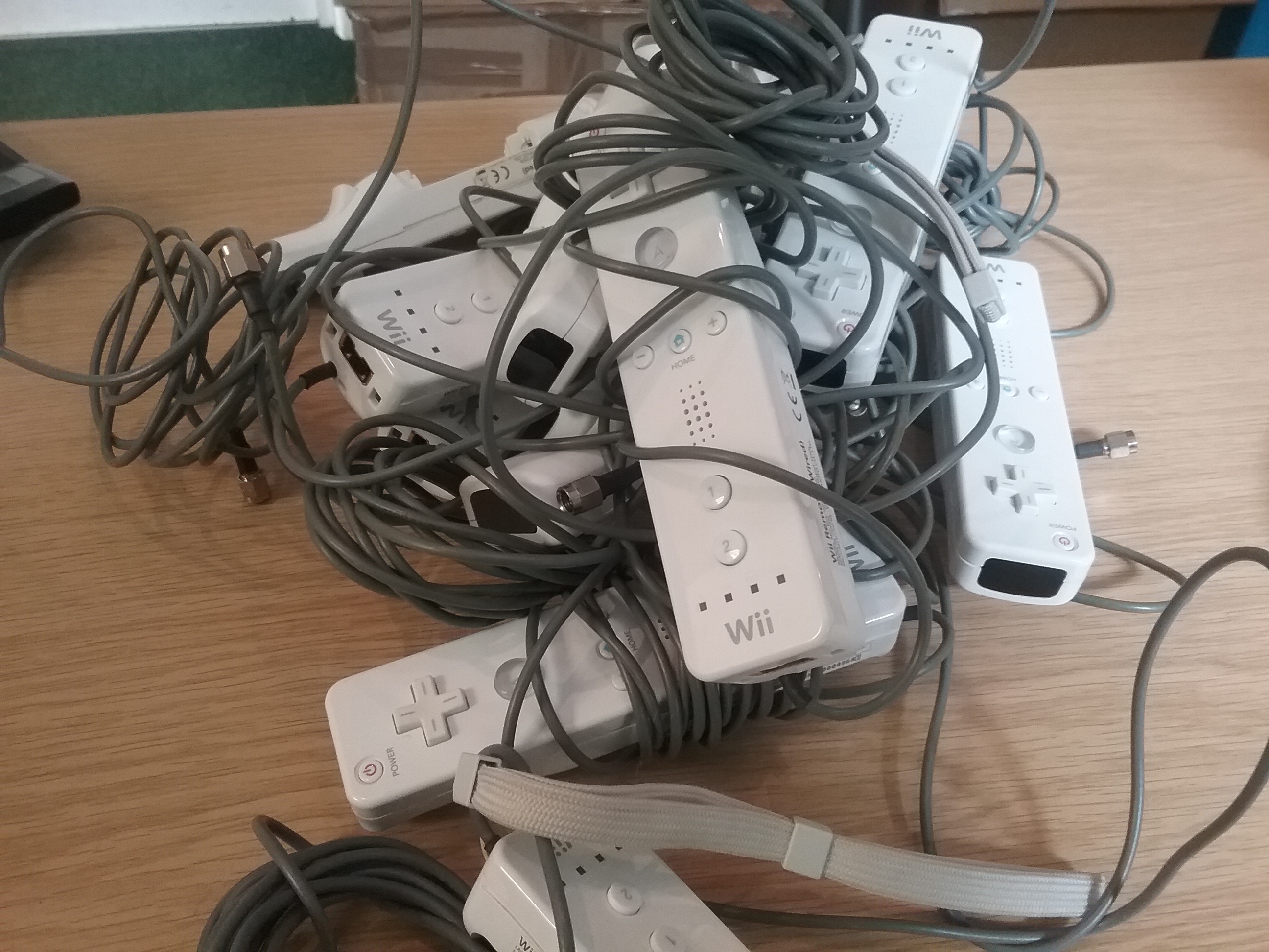

    Just a few more lol. Not selling here but are these worth anything to anyone or should I just dispose?

    If I am looking at how that RF cable is feeding into the battery terminal, it appears to just be an AC power takeoff. perhaps the RF cable connects to a power supply so batteries are not needed and the cable acts as a leash to the console. If this is the case then the Wiimote CAN be used with a regular Wii Console once a 3Volt Power Adapter is modded with the RF 2 wire connection.
  17. aspect
    aspect Site Supporter 2015
    Oct 11, 2011
    191
    The RF cable attaches to the PCB, it just feeds past the battery compartment. These controllers still need batteries. Do not feed +3V to the RF cable.
    These are modified retail controllers bypassing the internal antenna to instead feed the RF over the coax cable from the bottom. They attach to the wired versions of the NDEV and RVT consoles. I think the NDEV can be switched between wired and wireless mode, but the RVT consoles come in either wired or wireless versions.
