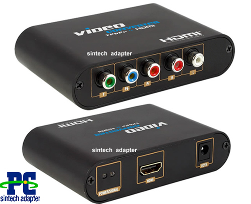

    You sure it can upscale 240p component to hdmi?
  13. LeHaM
    LeHaM Site Soldier
    May 5, 2013
    2,634
    292
    It doesn't say, whats the composite output res of a snes or core grafx
