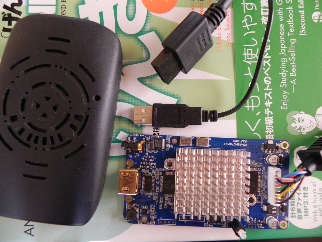

  9. DragoonC
    DragoonC Spirited Member
    Jan 15, 2013
    134
    i have some pictures around too...where are they...ah here they are !
    both are upscaler for Wii

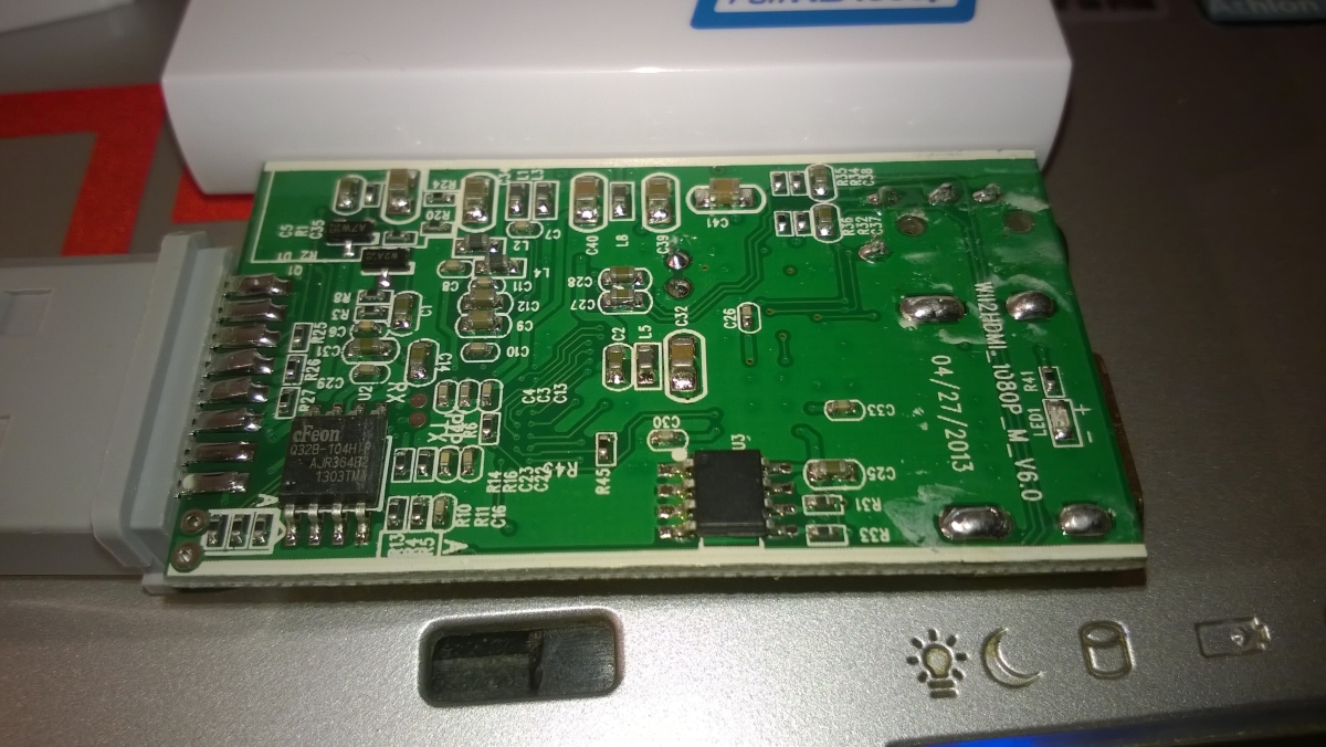

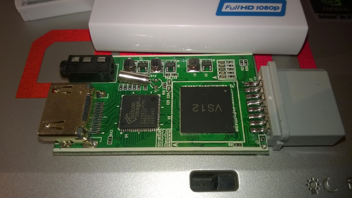

  10. Mord.Fustang
    Feb 17, 2013
    818
    182
    Got the black one in the mail a few weeks ago, haven't taken pics till now. This one says "FullHD 1080p" which is a lie (I don't need an upscaler, but they shouldn't write that on it when it's BS). Does not upscale. TV still reports 480p resolution. Works fine though just like the other one and I haven't had any issues at all. This one was US$9.60 on eBay.
    Main components:
    Edit: Following the link on the PCB, this is the product page:
    http://www.gaia-vision.com/?Product/HDMI-Converter/Product391/902.html
