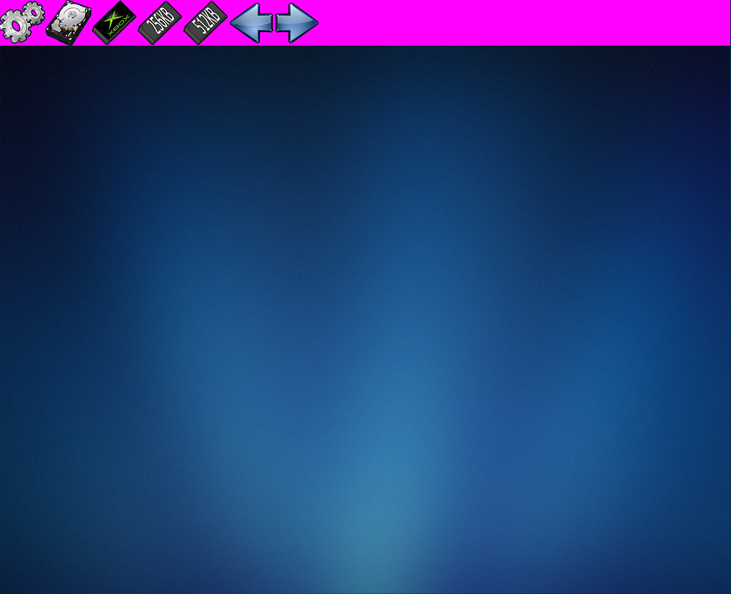

    I spent a little time messing with backdrop.jpg and tried to get rid of the nasty pixels. The best results would come from the icons being placed over a static colored background, without using magenta for transparency. I added a static colored backdrop to each icon to "blend" it in with the background by a general color. I didn't get to test it yet but the leftovers seen in the left arrow should be gone, as some things weren't aligned to 64 pixels.
    Here is the .psd if someone wants to mess around with the graphics.
    View attachment LPCOS_backdrop.7z

    Real nice work. This will give it a far better look! I merged your changes but in my excitement, I forgot to check the file size of the new backdrop... It's way too big to fit in the 256kb image. JPEG images will not shrink much size gzipped so I would try to keep it lower than 50kb.
    I compressed it down to around that size but it suffered the effect of it.

    Hmm.. 50KB then? I think it would be a good idea to only include a set of icons with XBlast OS. The whole 1024x832 image is a little unnecessary. Setting a background color and later loading an image from the HDD (if one's there and the file exists) would be the ideal solution.
    Bummer that compression kills it so bad. It seems to blend the icons with the magenta again.
    Well, looking more at jpg compression, it matters more of how many colors are in the palette and how detailed the image is than how big the image is. If I make the background 1 color without any magenta and remove the HDD icon, the size falls below 50KB, without compression.
    So forget what I just said about having an image big enough only to hold the icons. :p A graphic background is really limited without the space of the HDD.

    Added ability to load JEPGs files from HDD.
    Please do not use progressive JPEG and all these weird variants. Just plain old JPEG.
    For now, place backdrop.jpg in C:\XBlast\ for the background image. It must be 1024x768 in size.
    Place icons.jpg in C:\XBlast\ for custom icons. Icons are 64x64 and lined up horizontally on a magenta background (0xFF00FF in 24bpp RGB). You can place a maximum of 16 icons so the image max dimensions would be 1024x64. icons.jpg doesn't need to be 1024x64 if you don't put 16 icons in there. Just make sure its width is a multiple of 64pixels corresponding to the number of icons you've put in there. There should be at least 6 icons in there to accomodate XBlast OS. Just look in the "pics" folder in source repo to inspire you.

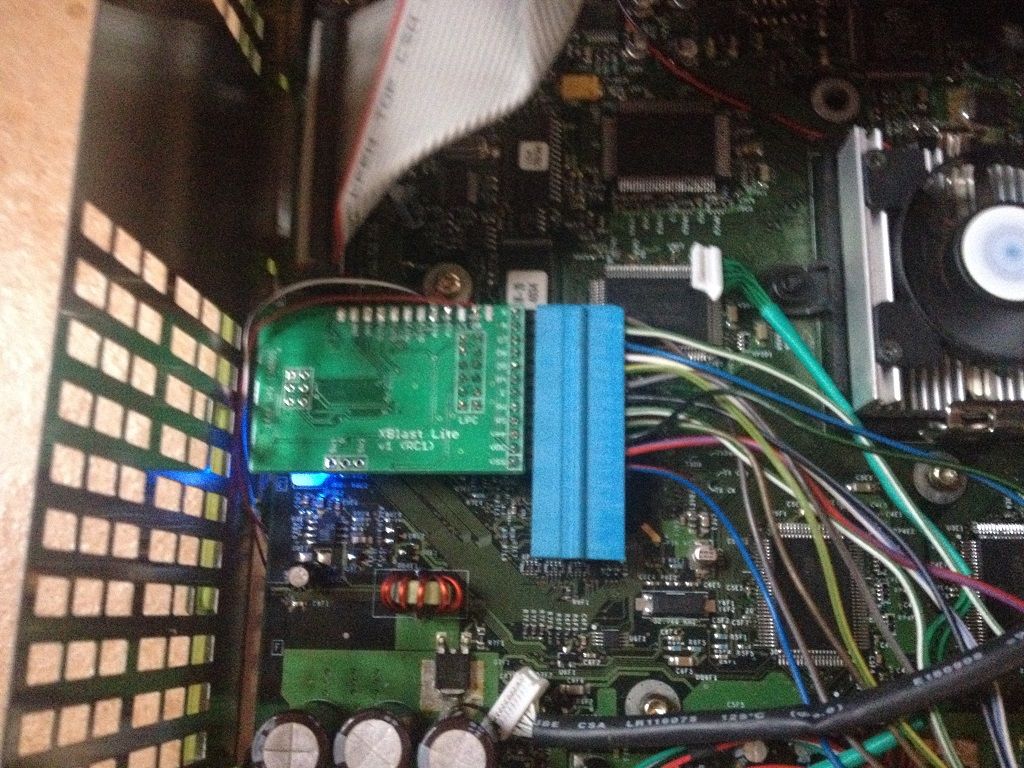

    Benny
    I received my XBlast a couple of days ago and have had a good play this weekend.
    I already had a partly disassembled console on my bench and I was feeling lazy and also excited about the chip arriving so it seemed a good excuse to get to work right away.
    The board I installed on is a V1.0 with a 1Ghz processor and 128MB RAM.
    My pics are a bit scruffy because this is an X3CP console so I wanted to leave all my other cabling in place.
    As I already had a pin header installed, installation of the XBlast was so straightforward and I was up and running in under 10 minutes. The chip is nicely designed with large solder pads that should make this pretty easy for a novice.
    I did a quick test to see if all was well:
    All good!
    I was itching to hook up an LCD display and I had a HD44780 laying about so on with that. I used a pin header/connector because I wanted to be able to connect and disconnect easily.
    Yay!
    I spent a good while prodding about in the menus and apart from a couple of small cosmetic issues that were already reported, it all works as expected. I went ahead and Net flashed X2 5035 and IND-BiOS 5003 to the respective bioses and that went smoothly too.
