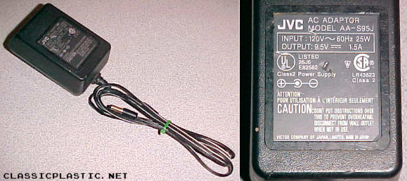

    That doesn't seem right... The best picture I can find looks center positive.
    And compare it with JVC X'eye, who definitely is.

  11. K1ngArth3r
    K1ngArth3r Robust Member
    Aug 3, 2008
    215
  12. Shane McRetro
    Mar 11, 2012
    2,078
    194
    LOL, that's centre positive for sure! :wink-new:
  13. Lum
    Lum Officer at Arms
    Sep 30, 2010
    3,233
    Yeah I don't know where the heck in Australia you'd find a Multi-Mega power adapter.
    Hard enough to find our version.
  14. K1ngArth3r
    Aug 3, 2008
    215
    I guess it's obvious looking at that picture :)
    just need to find a suitable replacement in the UK
