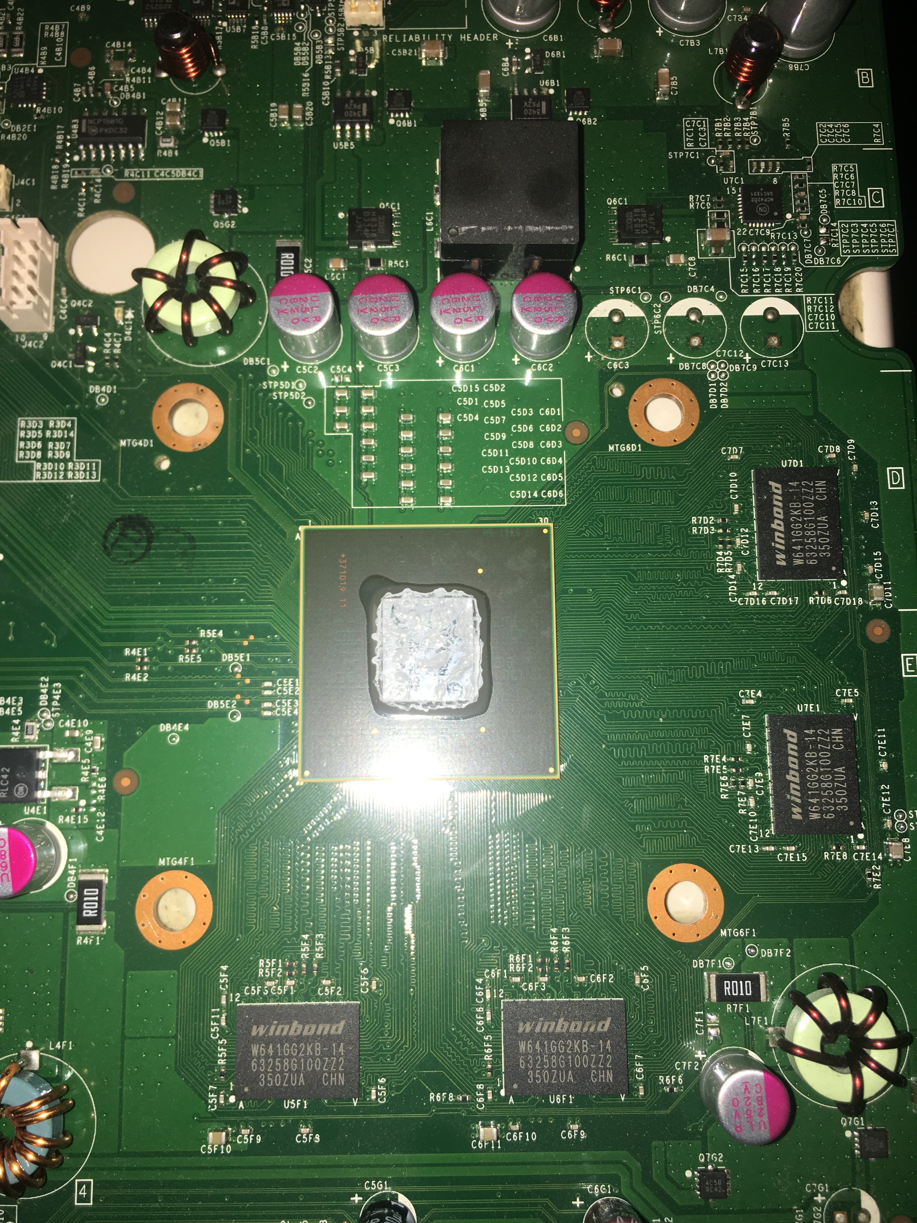

    To 100% confirm you have to take it apart. check under the board to see if it has the extra ram chips installed. If it does it can run 1GB mode.

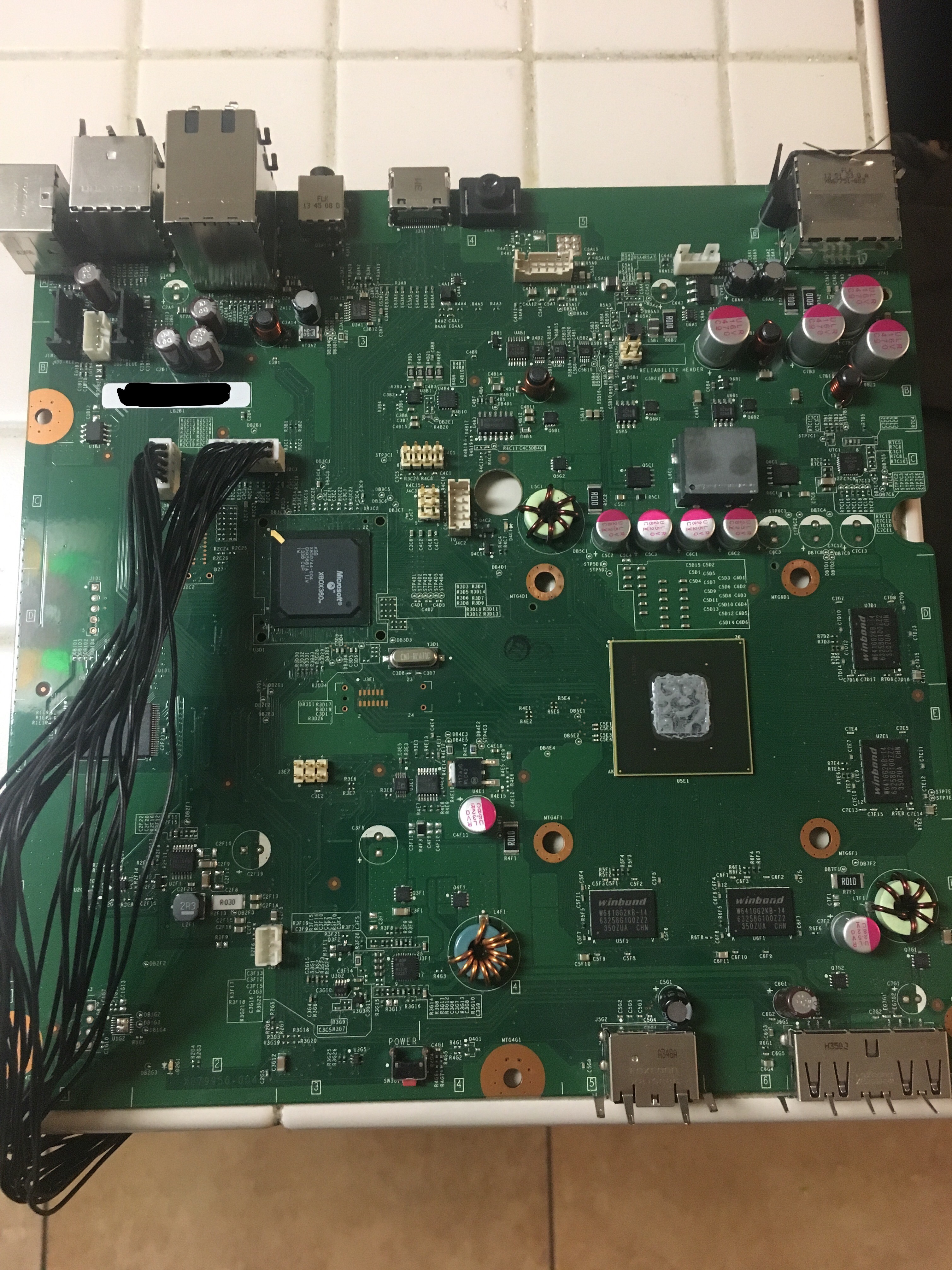

    This here is a Xbox 360 e Winchester motherboard. Like I said before to make sure it's not a Corona you have to take off the heatsink. I can confirm the Winchester motherboards do not have capability of running 1GB mode sense they don't have the extra ram chips installed under the motherboard.

    Another owner of a Winchester kit chiming in here, mine has stress cables too. I wonder how many there are in existence.

    broseph Member
    Jun 18, 2017
    I had it apart last night to confirm, definitely a Winchester. I didn't take photos though. Can't be bothered to mess with it and pull it to pieces again.
    Can also confirm mine only has 512mb RAM, and no extra on the bottom of the board.
