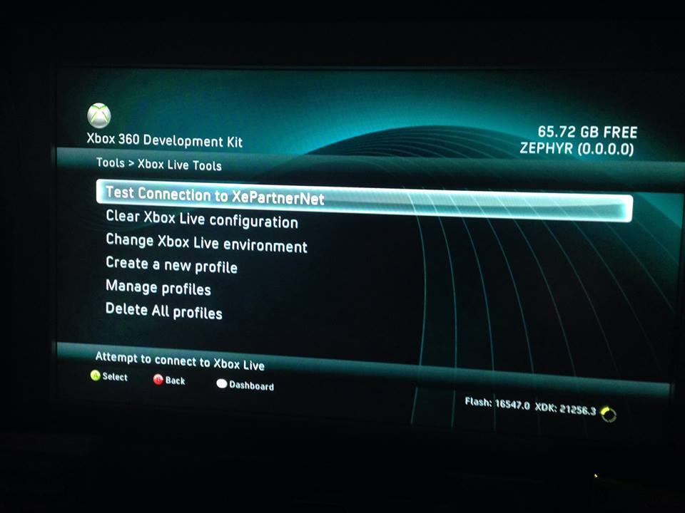

    No. XDK do not require any development files on the HDD/sidecar. What files are in "filesystems" on a retail console running an XDK kernel are on the official XDK's nand. Filesystems is on a RGH/Jtag running RGLoader's HDD because the retail NAND is too small by comparison.
    Flash refers to the retail dashboard. XDK refers to the Launcher version. Both are updated by a recovery via ISO or remote.
    You're running the most recent leaked XDK firmware, you do not need to worry about updating anytime soon.

    woo! surgeon to the rescue :) thanks for the info mate! id assume this is gonna be the last XDK launcher revision huh? :/ or at least very near to the last?

    I'm sure it wont be the last recovery but more than likely tapering off to the end as the Xbox 360's flame slowly burns out. You CAN upgrade and downgrade as you feel fit as long as it's not dramatic. For example going from 21256.3 to 1888.0 and back. There is not much of a reason to downgrade, but just know it's possible and safe if it's done gradually with official recoveries both iso/disc or remote based.

    That's awesome! i do like the look of those beta launchers! :D is there anyway to flash the XDK launcher revision with perhaps a .xex and a file that gets read of a usb? if so id flash down as soon as i can find some launcher files haha xD just for shits and giggles.. a console running 16547, yet with a beta launcher.. hehe
    i wouldn't if it wasn't safe like you said to just go down all in one go, if so. id purchase some many versions of earlier revisions so i can step it down date by date to be safe

    You won't be able to separate the flash and the launcher files, it'll corrupt the nand causing E71. Sorry, no 16547 running the beta launcher. I have tinkered with using a bladed dashboard.xex with a modern revision and it crashes the kit. All recoveries must be done with either ISO/disc or remote otherwise it can spell trouble that might not be able to be turned around for the kit.
