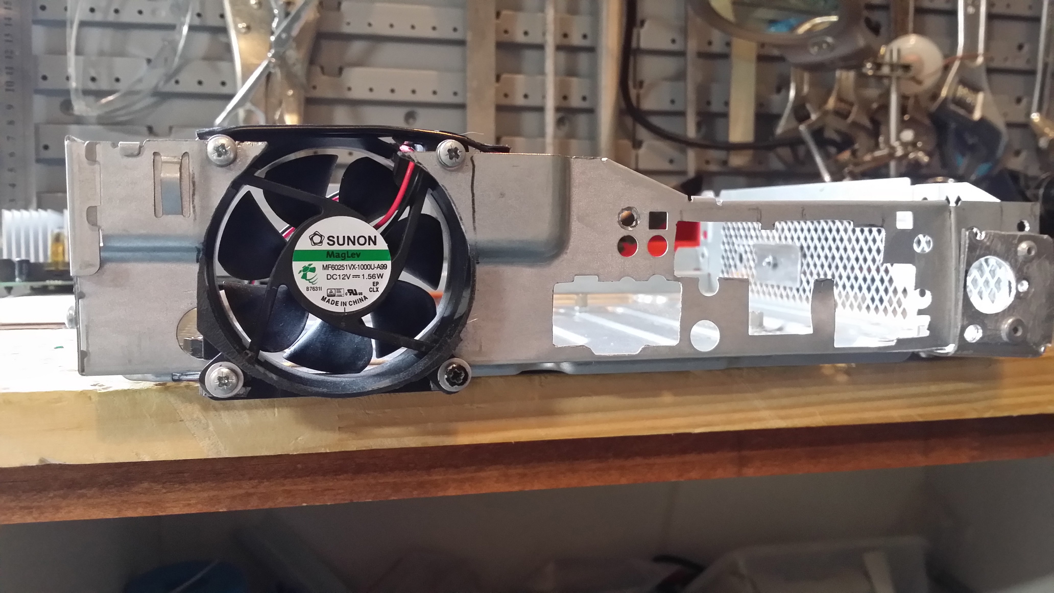

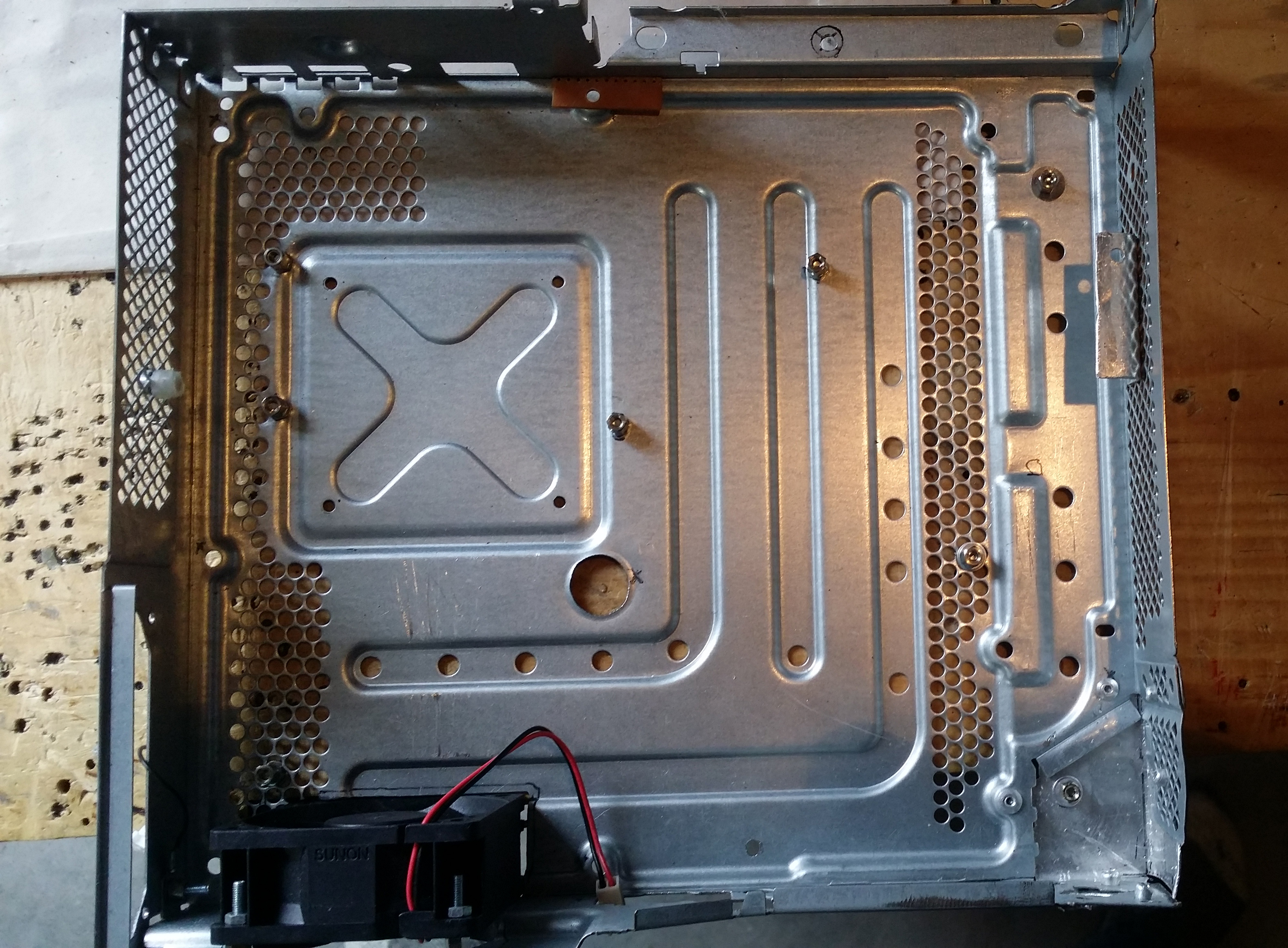

    First I gutted the x360, cut a hole in the rear for a fan, made cutouts for the rear connectors and added standoffs to mount the motherboard.
    Next I put the motherboard in and tested it with the original PSU. First problem, the fan wouldn't spin unless I started it by hand, not ideal. It was a 12v fan, just like the original. After some testing I found that the Xbox will output a constant12v on the positive line but will vary the negative line for speed control, and the start up voltage difference was too low for my fan. So my options were to get a new fan or some other solution. I chose some other solution. I added a delay ON relay that switches the fan negative from earth to the motherboard negative terminal. So when power is applied the fan gets the full 12v and a second later the relay switches and gets the motherboard negative fan control signal.

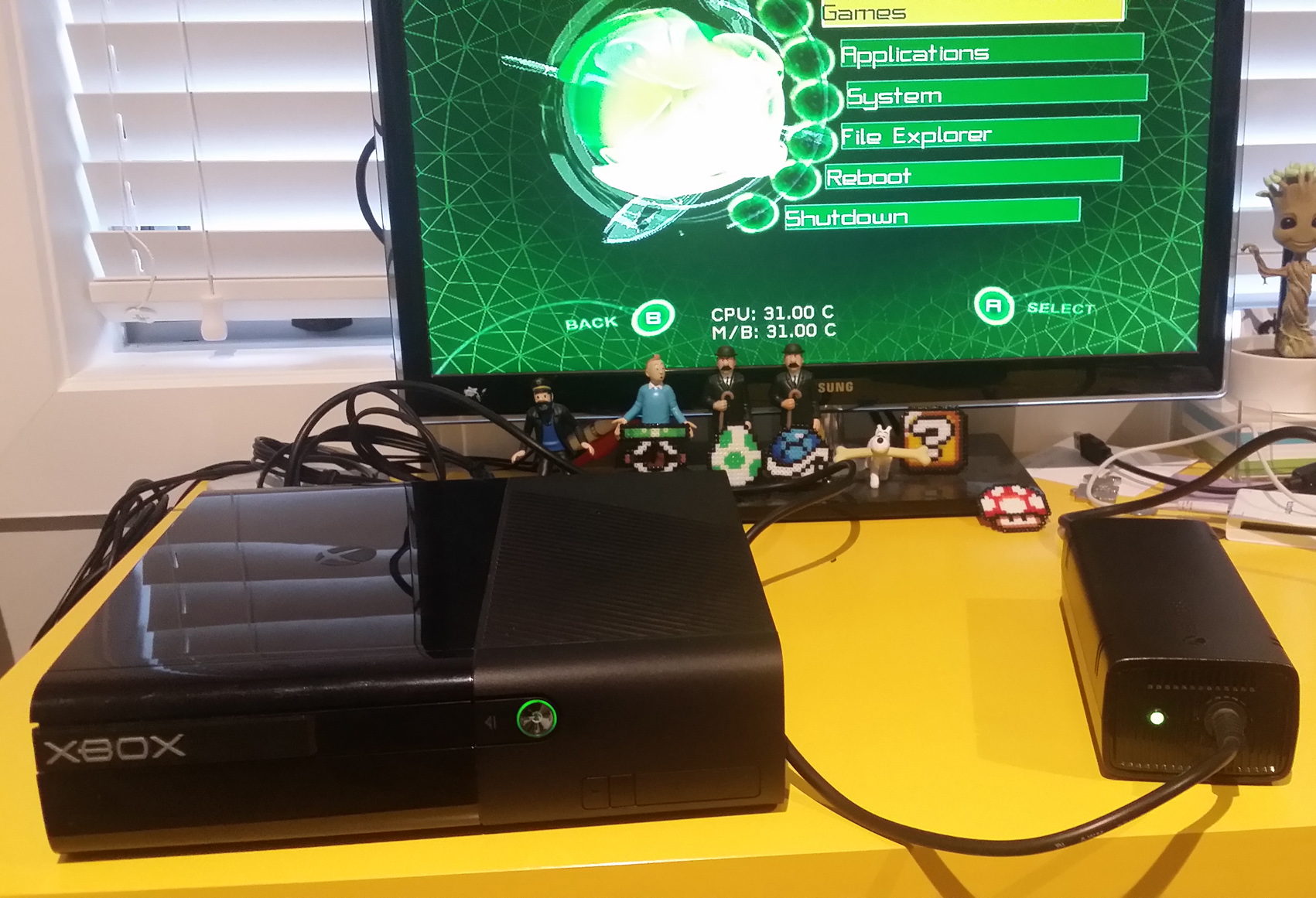

    And here it is all together. I use a wireless controller with the receiver in the back panel.

    Sould also add that i wired up the front panel so both the power button and eject button work (although there is no disc drive). Plus the outer led ring glows green and the inner led can be green or red or both.
    Normally when the xbox power supply is off the internal clock will reset after a couple of hours, and with this mod the power supply is off (only outputs 1.5A 5v standby) until the power button is pressed. To prevent clock reset I connected an isolated 3.3v power supply across the clock capacitor powered from the standby volyage which keeps it constantly charged.
