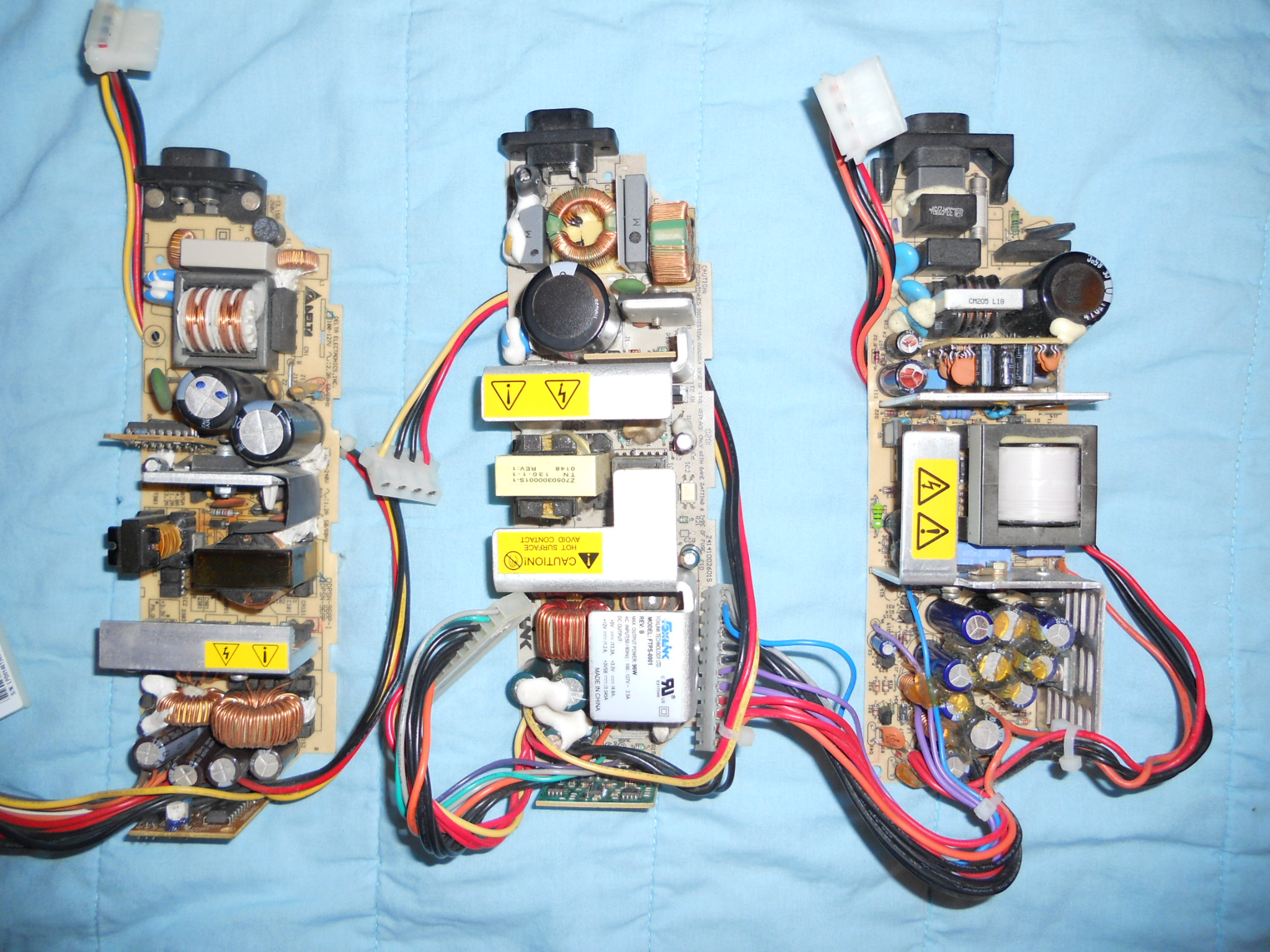

    I have a trusty 1.4ghz board with the RAM upgrade. It is a version 1.1 and I need to install a new power supply. What is the best power supply for the XBOX? I have a few different types to choose from. I want to the best for that board! I have a bunch more to look though later to see if I have anymore different ones.
    They are this order in the pics Delta, Foxlink, and Minebea
    The Minbea Electronics UK LTD I have never seen before and it seems to be built different then the rest. Not sure if that is a good thing or bad thing.
    Also should I use the official GFI power cord? Or the regular power cable with no GFI? Pros and cons?

    I'd say find the "coolest" running one, as I've noticed the bottom of the hard drive carriers show heat damage on some consoles. Are all 3 of those AT connectors for v1.0/1.1?

    Yes they are all AT connectors for the 1.0/1.1

    What do you think about the Minebea? Is that a official PSU? This is the only 2nd one I have had.
    Also which is the manufacturer that the socket for the power cord seems to get loose and short out? I have had a few over the years that buzz and smoke from a short circuit from that loose socket. I just did not note which one it was.

    According to shops that repaired XBOX systems, Minebea were the most wanted PSUs. Unofficial PSUs were not branded iirc.
    Probably Foxlink.
  7. Borman
    Yep, the Foxlink power supplies are awful. I had to fix my solder joints multiple times on it, such a crappy thing.

    You are correct it is the foxlink. I looked for the one I still had that burnt. This one was so bad even after I solder it again it would not stop shorting. The other 2 manufacturers secure the power connector to the board. That foxlink is not secured at all! That is such a bad design! I am leaning on using the Minebea now. It has a fuses right next to the power connector. Also according to HEX1GON they are the choice of the repair shops.

    I repair my Foxlink once, but a few weeks later it started buzzing at me... They are horrible, reason why many people's XBOX systems caught fire :p

    I just looked at Foxlink from a 1.2-1.5 and they fixed the problem with the power connector. It is riveted down to the board now like the delta 1.0/1.1 PSU
