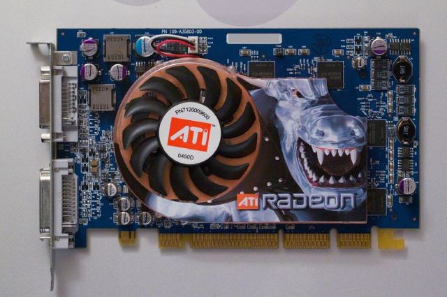

    I have 3 of these now, 2 working and the other hangs on boot.
    I compared "printenv" on the 2 systems in Open Firmware. Both are identical in settings and specs, one difference I noticed on the non-working one is it has newer firmware: apple powermac7,3 5.1.8f7 bootrom, compared to: apple powermac7,2 5.1.4f0 bootrom.
    I can see and view the dir listing of the hard drive and manually type "boot xeboot" and watch it ELF load the xboxroma.bin file but just freezes.
    Could be the 1029 is too old for the newer firmware on this box, I'll know once I swap video cards and memory to confirm.
    I'd love to see open firmware in verbose while it's loading/freezing to see what's preventing it from booting.
