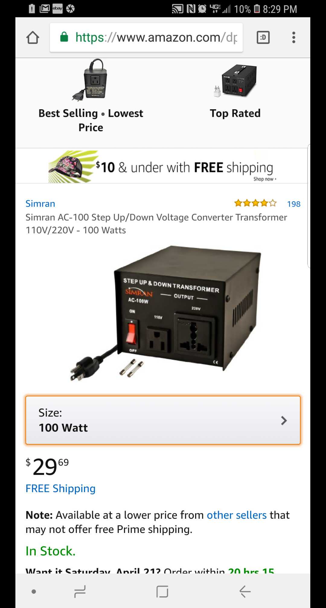

    Now the setup transformer they make 100 watts all the way to 2500 watts..do u think a 100 watt would be fine or should I get like a 300 watt
  8. TriMesh
    Jul 3, 2008
    2,324
    Well, the PSU is rated at 213W, so you need at least that. 300W is probably a good size.
    Wolfcarnage likes this.

    Is this why it is recommended 300 watts?
    TRANSFORMER PURCHASE GUIDE: Remember to leave at least a 100 percent slack for the Voltage Converter Transformer. for TVs, Xbox and PS3 consoles, the power surge margin is 3 times the wattage rating of these products. Heating appliances, laser printers and power tools spike when you turn them On. For these products you need to buy a Voltage Converter Transformer that is at least 3 to 4 times the rated wattage.
  11. TriMesh
    Jul 3, 2008
    2,324
    That really sounds like they are horribly low quality products. I have a 220->120V 3kVA stepdown transformer here and that has a 100% overload rating for t <= 100s - I.E. it will supply 3kVA at 100% duty cycle and will supply 6kVA for up to 1m40s.
    It anyone gave me a spec sheet that recommended derating the output by 75% I would throw it away and start looking for another supplier.

    Those were Amazon guidelines lol I doubt they know much there about power supply guidelines for XDKs lol
