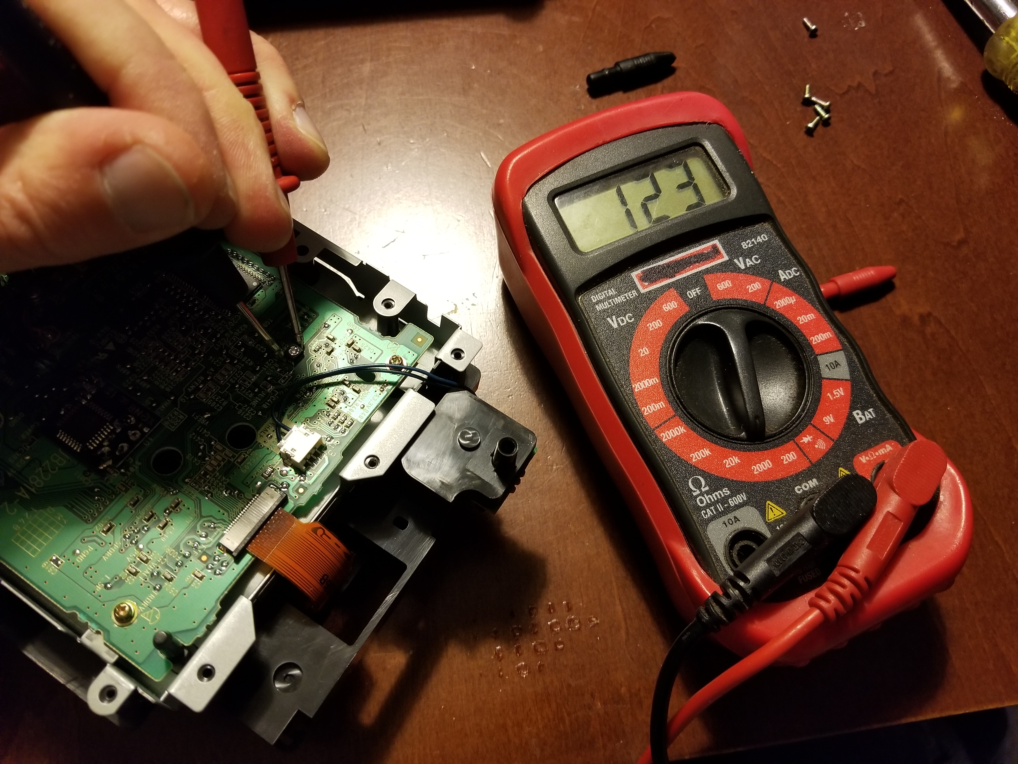

    Tried it one more time and by dumb luck, it works. I have to adjust the pot as the disc kept freezing during the cutscene. Trying to read it with the multimeter and it jumps, but always ends at 000. I have it set at 2000ohms and no matter where I put the red and black tips and in every order, same thing.
    Can someone tell me why that may be?

    a Gamecube coder once told me to start at about 550ohms and test , if that doesn't work lower it by 50ohms and keep testing/reducing. Try not to go below 100-110ohms as that will kill the laser , also use games like Metroid Prime 2 - Echoes and Super Smash Bros as they make the GC's drive work hard. If you get a good result with those games you're all set.

    Bad meter? It should hold some kind of constant value. If the GC is working I would suspect something funny with your meter.

    Got it to work finally at 170, but now after about an hour of playing, it won't read discs? Do I need to lower the laser or what should I do? All my discs are Ridata burned at 2x.

    Always recheck your pot after you let it run like that. Especially if you had to adjust to begin with. It will change from your 170. You can readjust back to your number it was working at and see what it does. Did it drift up or down? If it went up try going down to 160 and see if it is more reliable, and vice versa. With the age of the lasers and depending on use they can be very picky. Have you checked it with multiple games?
    As far as lowering or raising your values it all depends on what your original benchmark was.
    I backup my games using imgburn on my laptop. It will not burn lower than 4x. I use Ridata mini and Full size depending on which Cube. 99% have worked so far. You can get a bad burn here and there. It's not umcommon.

    Here's the last one I did just so you see there is no "magical number". I have plenty others and they all vary. If you have it reading a disc you must be onto something.
