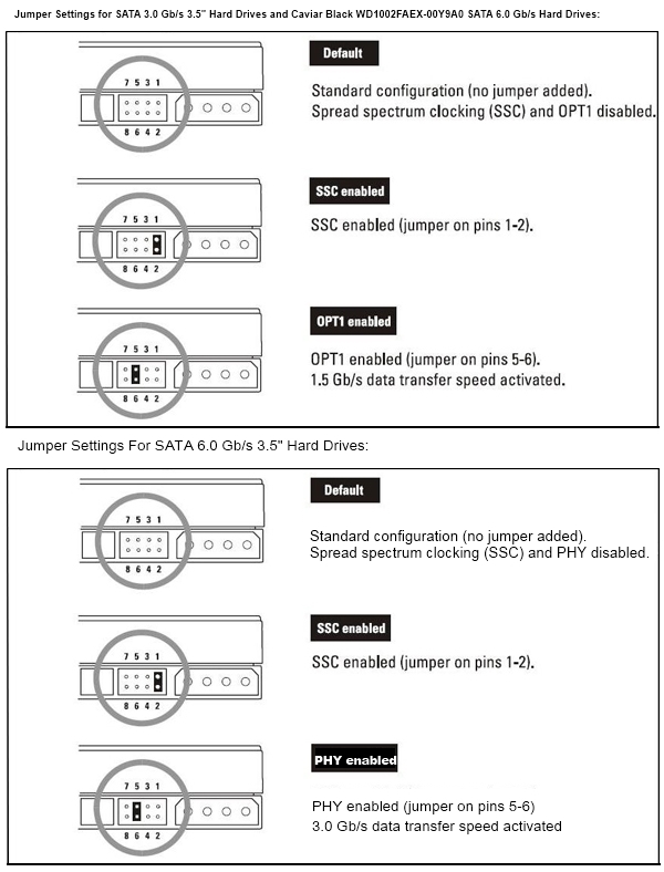

    In case this helps someone out there, this is for WD SATA 3GB & and SATA 6GB drives to force 1.5GB mode.
    Traace, oldengineer and bowser22 like this.

    For Hitachi HDDs all whats needed is a PC with BIOS that supports SATA in IDE Mode. Then boot the Hitachi Feature Tool with it.
    https://www.philscomputerlab.com/uploads/3/7/2/3/37231621/ftool_215.iso
    Burn this disc,
    boot it up,
    choose the HDD.
    change HDD speed to SATA-I (1,5GB/s)
    poweroff.
    done
    Jumper settings from Apple certificated seagate HDDs are compatible with "non-apple". But I forgot the exact position and need to take a look again.
