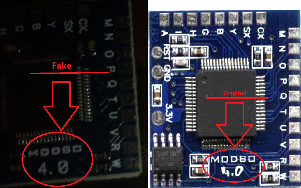

    Hey everyone,
    I decided to start up a side job on selling chips and modding systems for mainly Canadian convince so i looked up a couple suppliers and i found this. Seems legit XenoGC 2.0's and Aladdin XT PLUS2 are originals but they had modbo v4.0 copys and they only sold the original ones by 100's and the copys by 10's. So long story short they said they'd give me 10 original ones but im starting to think their the fake ones. Installed one in my V9 PS2 and seems good, Matrix logo at the beginning etc, but when i try to save some settings in the matrix configuation menu it just freezes and when i restart the ps2 it doesnt save. it boots ps2 backups/Imports and ps1 imports but no ps1 backups. so i tried to enable PSX multi-disc setting to see if that would fix the issue but then this problem occured.
    Just made this pic.
    Thank you guys for looking .

    take a picture of the whole chip.
    I know some MODBO-CHIP are re-branded to Modbo 4.0, I hope you got the 1.93 and not the 1.99 or 2.0 which have lots of compatibility problems

    these are 1.93. Just installed a new one just to be sure if its a defective or not and still freezing when trying to save settings. I wish DMS4 or Matrix were still around

    Pretty much, It locks up just as i hit start, it still shows the menu like in the pic (actual pic of the lockup).
  9. Bad_Ad84
    1,309
    Sounds like it cant write the settings.
    Whats the part number of the eeprom? might be worth looking up the datasheet and see which pin enables/disables writing and checking it out.

    Afaik the original 1.93 Modbos are able to save the settings.
    I even remember that at one point (around 1.82 or something?) they even supported official Matrix Infinity update discs to update themselfs or something.
  11. Bad_Ad84
    1,309
    Yes, they are.
    Which is why I think the eeprom is write protected, causing it to lock up

    There are also some clones that have the EEPROM on boards, but no tracing leading to the IC.
    I'll try to find that picture again.

    I cant seem to make out the writing on the chip. Is it the 8 pin chip or QFP?. I ordered a pair of 20X Magnifying glasses which i think should come possibly today. From what i can see from just the naked eye is "27F29724"? which is the bottom of the 8 pin soic?
    A7MC(X)424? on the top X=?

    The 8 pin chip is the one of interest.
  15. Zer0-2k11
    Jul 18, 2012
    542
    After looking at this 8 pin chip for a little while it looks like it came out to
    *Edit*
    This is the correct one last one that was posted was wrong, my apologizes.
    ATMLH850

    You got a clone of a clone, the Modbo 4.0 1.93 do not come with the Diode Laser Fix also known as the PTR-5
  17. Zer0-2k11
    Jul 18, 2012
    542
    Ahh shoot i figured that much...its not that bad i guess. Time to consider throwing these in the trash can :mad:
