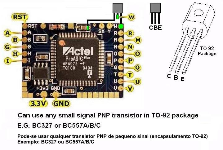

  14. l_oliveira
    l_oliveira Officer at Arms
    Nov 24, 2007
    3,879
    245
    That was a hardware problem. It was solved with a transistor to insulate the circuit and avoid the ACTEL CPLD from draining current from the chip enable pin of the ROM.
    The integrated IOP core (inside the larger chip) on these new units was designed to detect current being drained from the bus and then stall boot if that was the case.

  16. iCEQB
    iCEQB Peppy Member
    Feb 22, 2008
    322
    36
    You mean this mod?
  17. l_oliveira
    Nov 24, 2007
    3,879
    245
    Yes, that one.
  18. iCEQB
    iCEQB Peppy Member
    Feb 22, 2008
    322
    36
    Does this mod have to be applied to Modbos aswell? Or do they come equipped with that transistor?
  19. l_oliveira
    Nov 24, 2007
    3,879
    245
    That does not apply to modbo chips because they use a different CPLD and also they have a resistance with a higher value on the "W" point.
