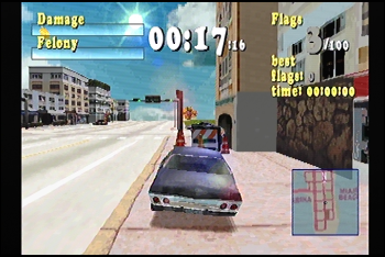

    I compared the video output of some of my PS1 models.. my observations:
    SCPH-7502, SCPH-9002, SCPH-102 have the same video encoder chip (A2106R) so the difference in output quality between these models is negligible. Here are some s-video captures (SCPH-7502 vs. SCPH-9002 vs SCPH-102 in NTSC 433):
    As you can see there is noticable noise / interference (for lack of a better word) in the picture... I don't know if this noise is also present when using an RGB cable, but I don't have the proper equipment to capture RGB signals (SCART input).
    I also tested SCPH-5552 and SCPH-1001 models.. These have a CXA1645M video encoder chip on board. The problem with this chip is that, for s-video or composite output, you will need a color mod to get proper colors with games that are a different region than the console (so PAL games on NTSC console or NTSC games on PAL console). If you're using an RGB cable, there is no problem though. I was only able to do an NTSC M s-video capture on my SCPH-1001 (the SCPH-5552 gave me "rainbow" colors because it's doesn't have a color mod):
    What surprised me here is that the image contained almost no noise / interference, unlike the newer models.. Although the picture seemed to be blurrier / less sharp than on the newer models.
    Would be nice if someone could do some proper RGB captures for comparison, but for now I agree with some of the other posters that the SCPH-7502 is the best model if a parallel port is needed. If no parallel port is needed, then the PSOne is a nice compact alternative. The newer models seem to have better lasers (which are also cheaper to replace than the lasers in older models) and are able to output both NTSC and PAL signals without a color mod or RGB cable..

    PS1 connected to easycap usb device with s-video cable.. then recorded with AmaRecTV with lagarith lossless codec... opened in virtualdub with yadif deinterlace
    I also tried RGB scart > scart coupler > scart to s-video > s-video cable > easycap usb.. but directly to s-video obviously looked better :D too bad the scart capturing devices are all so expensive, so no full blown RGB capturing for me
    ps. what mod are you talking about with the 750x? and how is that different from 900x and psone? because I thought those 3 were sort of identical in terms of video output, with the same chips (my 7502 didn't need any mod to output color in s-video)..
    But I agree with your findings about the SCPH-100x.. the one that I have here also has problems reading backups but it seems to read retail copies fine. A replacement lens (KSM-440ACM) is also more expensive than the KSM-440-AEM that is found in 750x and 900x models.
