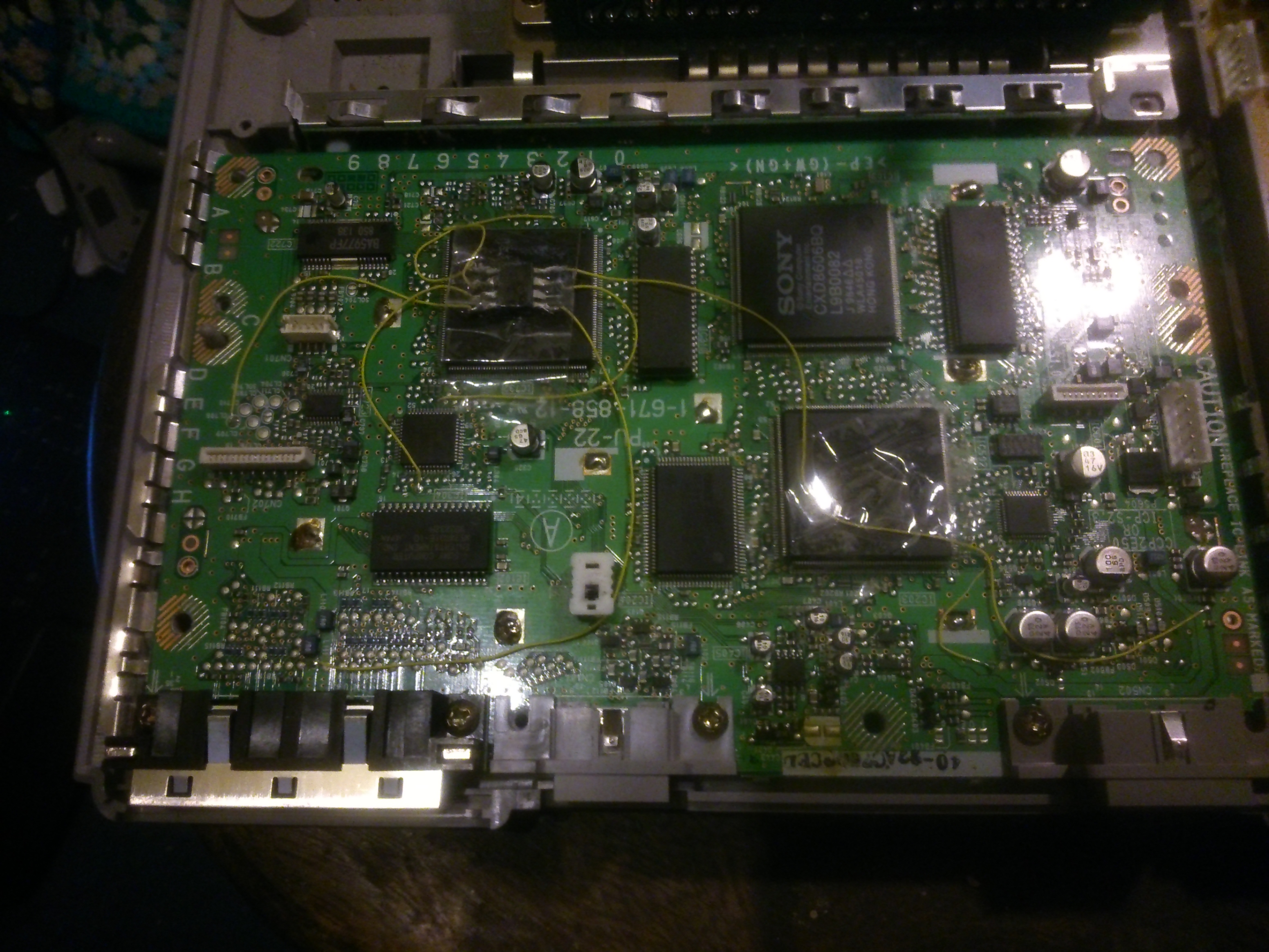

    SCPH-100* has horrid laser issues and squeaks. To make matters worse if the laser struggles during boot, the modchip mistimes sending the second authentication signal and you're left with a hang at the PS logo screen until you power off and try again. Also the MM3 chip does not support stealth for this version, so I had to add a switch to support anti-mod games. As I have two of these (one for each TV standard) I can say that neither can mix and match. You get black and white even on a LCD TV if you use the wrong standard (unless of course you use an RGB cable, but my TV only has one SCART socket, and it has too much daisy-chained to it already! Therefore colour over component is preferred!) Sometimes the CD drive misbehaves and tries to send the inserted disc into orbit if it can't read it by spinning ridiculously fast with an unpleasant laser clicking sound. Picture below is the SCPH-1001 modchip install (and is the neatest I did. I took this photo before adding a switch).

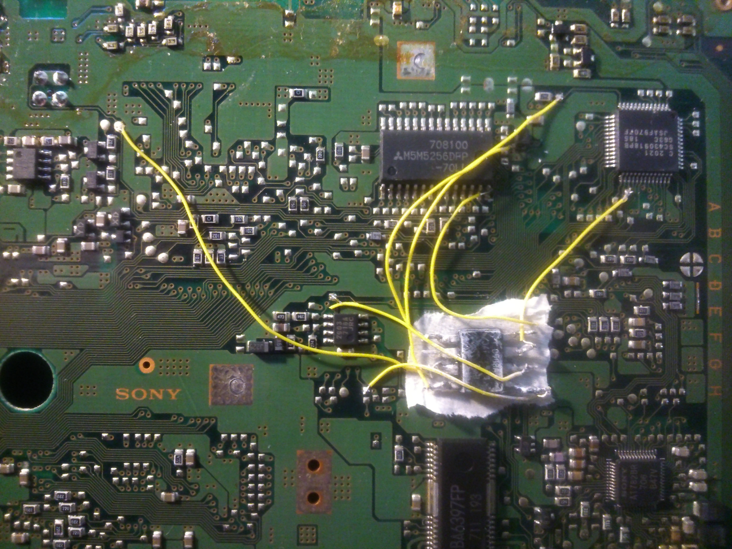

    SCPH-7002 is the most stable I have and my favourite. No struggling laser whatsoever and clean FMV on all discs- original and burnt. Plus the MM3 chip I fitted supports stealth on this version, so no fiddly switches! It also has the 60hz mod to allow NTSC games to play in colour. I must say this was the hardest one to mod of the 4 consoles I have successfully personally modded so far, due to having to solder onto a tiny component pin, and directly onto a resister. At one point I bridged the resister with one below it with a blob of solder by accident, but managed to clean it off without further damage. I was amazed when the console not only still worked but was a successful install! So overall, a cumbersome modchip install process, but well worth the effort in the end. The picture below shows my efforts, using sellotape to avoid the wires pulling (not the neatest but at least it stays put). You can just about see the 60hz wire mod on the left but you can't see where I've lifted pin 157 on the GPU. I used a wire for this as I didn't want to solder directly across traces.

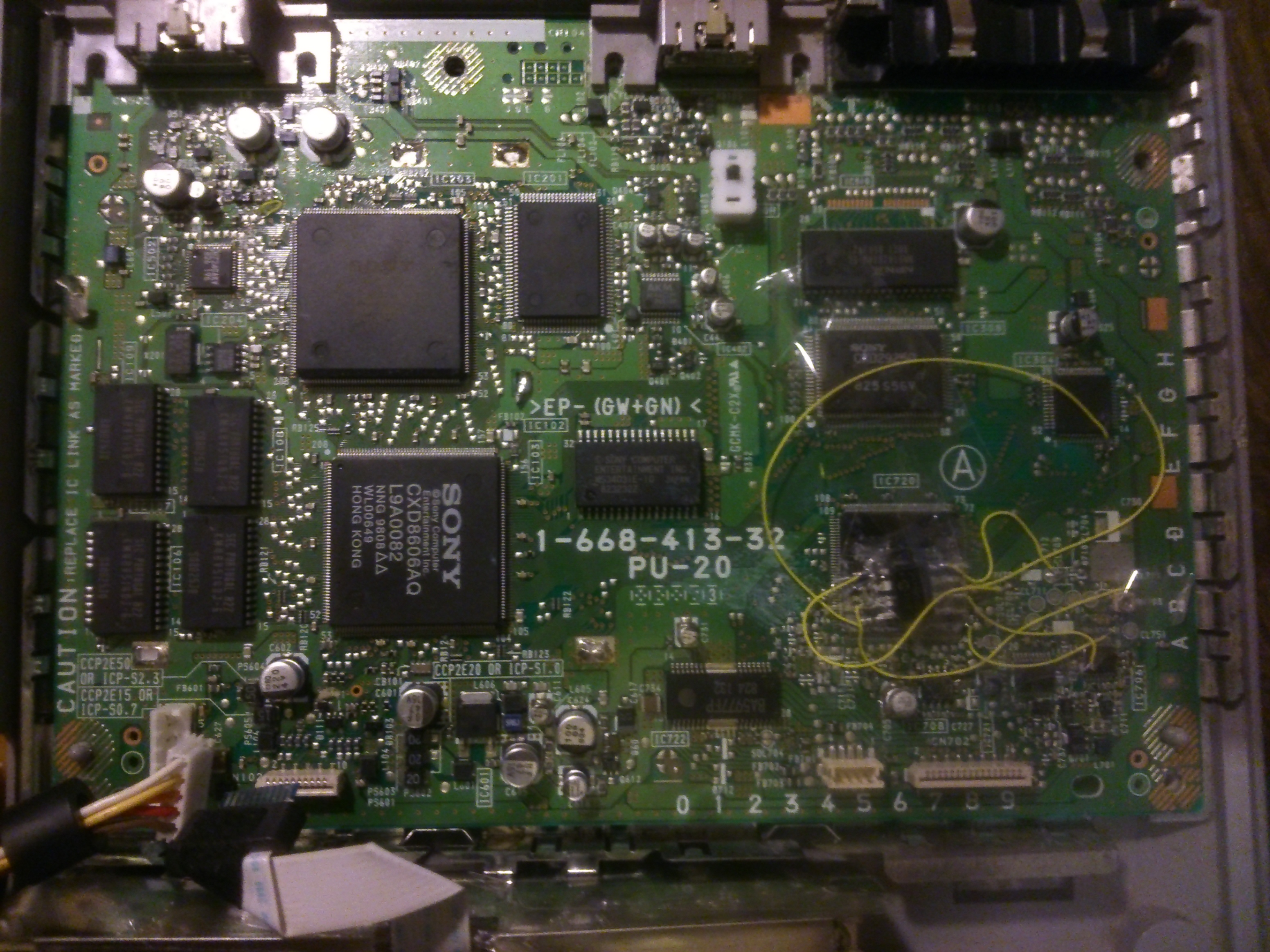

    SCPH-7502 is the second most stable I have. The laser struggles slightly on some burnt discs but overall works reasonably well. Again the MM3 chip supports stealth on this version, and I performed the 60hz mod on this one as well. It did once fail to boot a burnt disc and hang at the PS logo screen, but I put that down to my soldering rather than the console itself (I don't exactly have a steady hand and so the wires are longer than they need to be but I only recently got into soldering). I did place a new laser unit in this console but the issue remains, so I guess it is my soldering. You can just about see the 60hz wire mod on the right and I accidentally broke pin 157 off the GPU so this mod is irreversible now. Again I used a wire for this as I didn't want to solder directly across traces.
