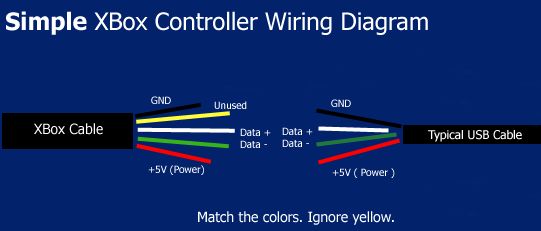

    Actually, I just ordered the USB to Xbox Controller Port adapter and I found one of the black label games on ebay for ten bucks. I'll just use that method, way safer.

    Splicing doesn't require soldering. Just twist the wires together and insulate them with electrical tape. Also (not needing to de-solder them) it's easier to reconstruct the breakaway cable when you're done (transferring the softmod file from your PC).

    Really? Huh, well maybe I'll try it if I get impatient. Does it matter what controller port is used? I have this one accessory that plugs into the Xbox controller port which you would plug in a mic I think? I have no use for it and wouldn't mind trashing it. Also, know any tutorials for doing it? The ones I found had you soldering stuff for some reason.

    That can't possible be that simple. Where do I cut? Do I simply take a female to whatever USB cable and cut part way down the wire, then take a controller port cable, do the same then twist up all the wires? It will work just like that? Don't they have to be the same colored wires?
