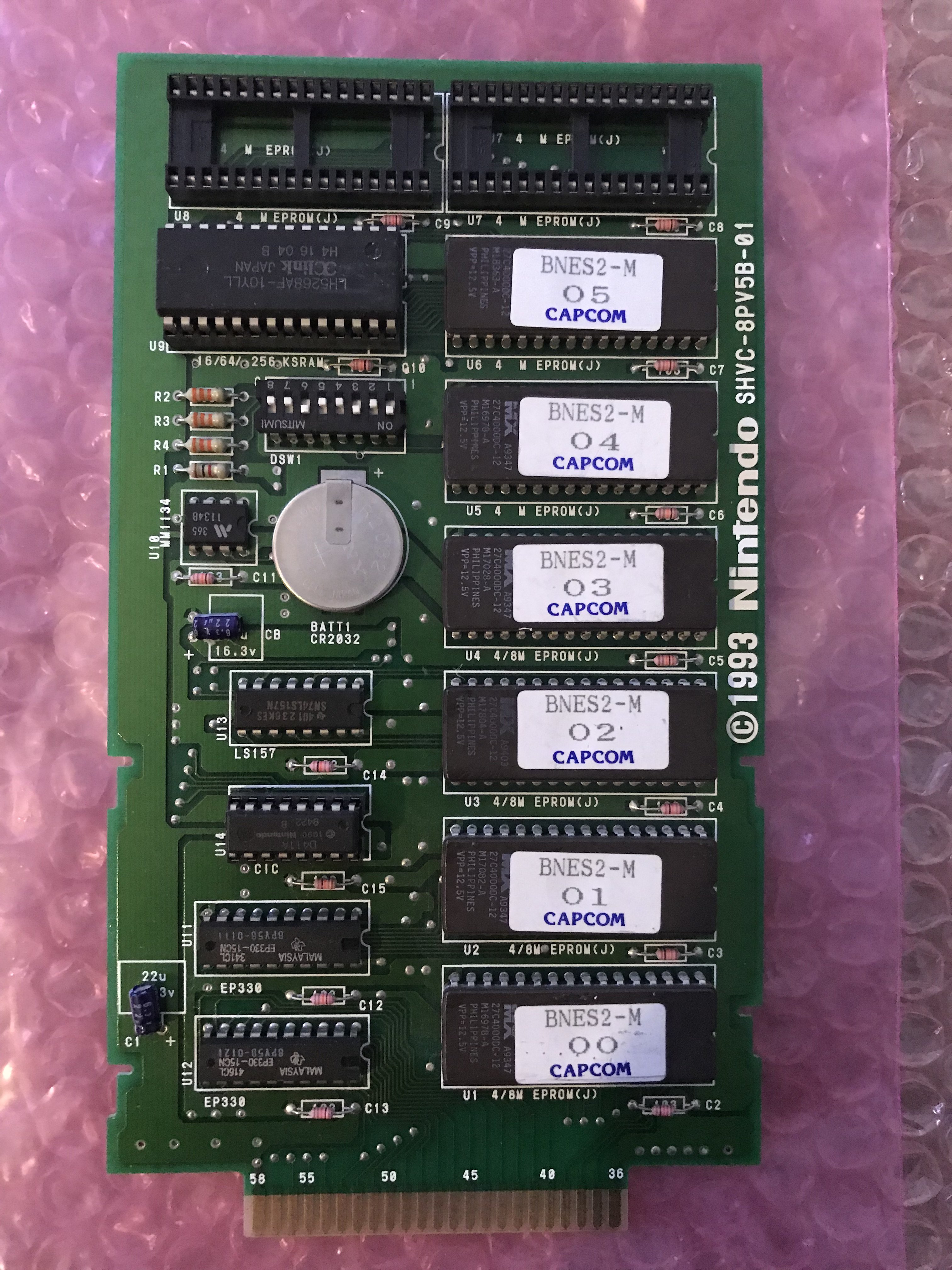

    I found another Breath of Fire 2 NTSC/US Prototype cart. This one is different from the Carts on hidden palace. It has Capcom Stickers. It holds the US Version of the game CRC32: 72B5F02B . I used Sannis tool to dump the cart and it gives me a 4MB file that i compare with the final and the other proto. The dump work but im not sure about the 4MB, because retail and the other proto is about 3MB.
    Here a picture of the cart:

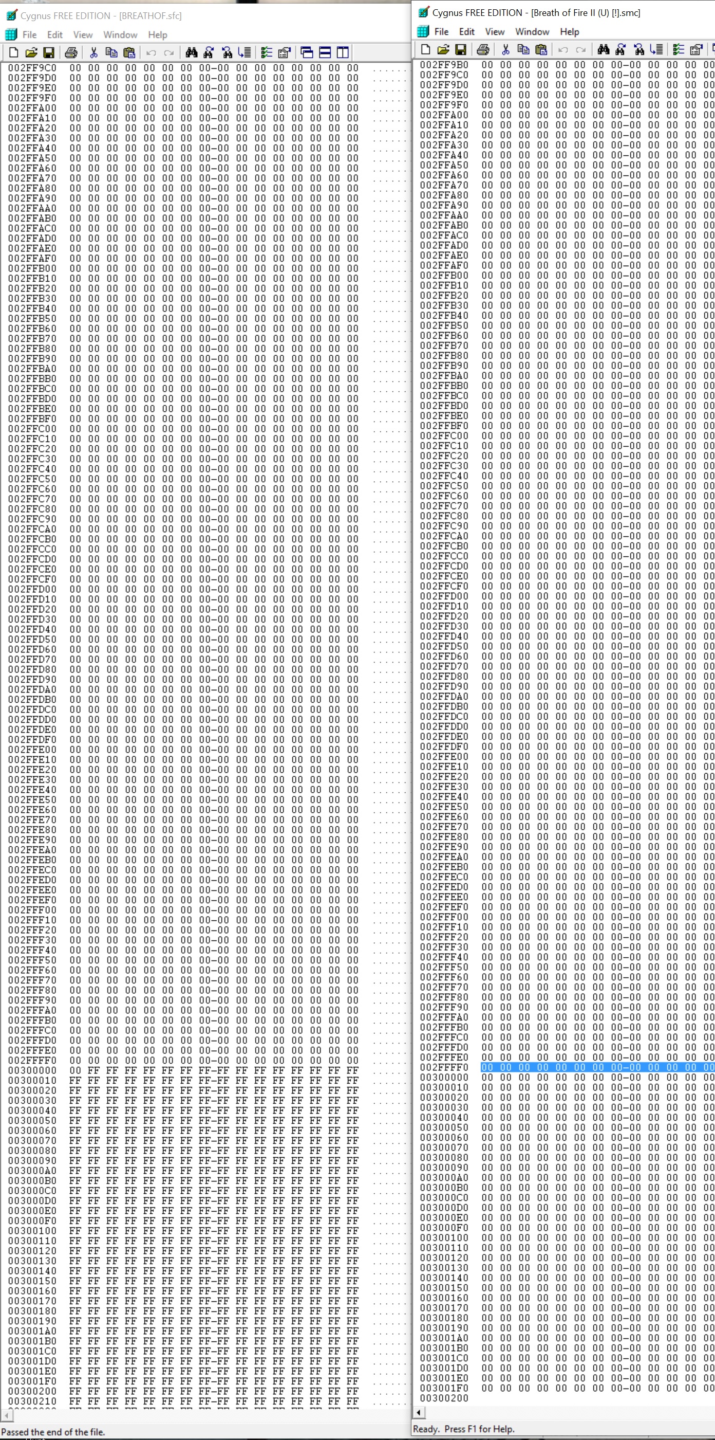

    Thanks for the tip Andrew! I checked the retrode site for instruction. But even if i force the retrode to do 24Mbit he gives me 32Mbit Rom. I tryed also the dump correction mode on and off. Hi/Low Rom... Than i was thinking to update the firmware of my retrode.
    But after the install of Flip Win10 dont get the DFU mode of the retrode. Always usb connection dont work any more ..
    Thats how the two roms end. Left the Protooverdumped 4MB and right the us retail version. Can i just cut it there?
  7. Bad_Ad84
    1,308
    yes, FF is blank/nothing.
    Just cut the end off, make sure its exactly same amount of bytes as the retail.

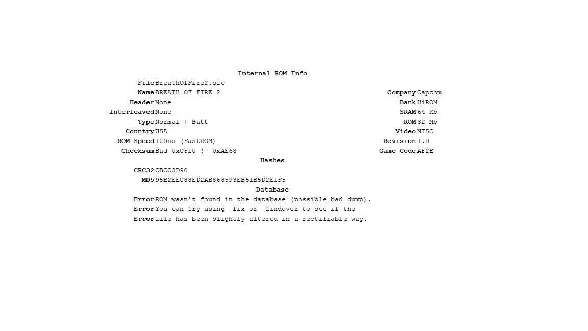

  9. Xzx123
    Xzx123 Robust Member
    Mar 19, 2013
    271
    65
    What does the internal header say about the ROM size?

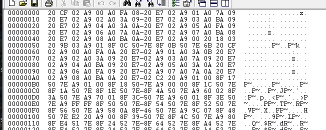

  10. Jackhead
    Jackhead Site Soldier
    Apr 2, 2008
    2,433
    610
    Dont know, here the head of the File:
  11. Bad_Ad84
    1,308
    It can't be anymore than 3MB. The chips on the cart total 3MB.
  12. Xzx123
    Mar 19, 2013
    271
    65
    I was wondering if an improperly set ROM size in the header was throwing off the cartridge reader. Not that it really matters, I guess, since it overdumping instead of not dumping everything.
    The SNES header is located elsewhere. You can run the ROM through NSRT and it will give you a clear readout of the information in the header.
  13. TriMesh
    Jul 3, 2008
    2,324
    The ROM size byte in the header is stored as the number of times you have to left shift 0x400 to get the ROM size. As a result, it can only represent powers of 2. It's presumably set to 0x0c, which would make the size 4MB and would account for the overdump.
