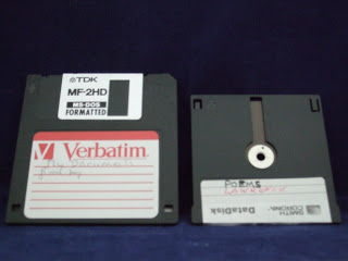

    doesn't the FDS just use quick disks? (Slightly modified ones)

    Yeah they did use quick discs.
