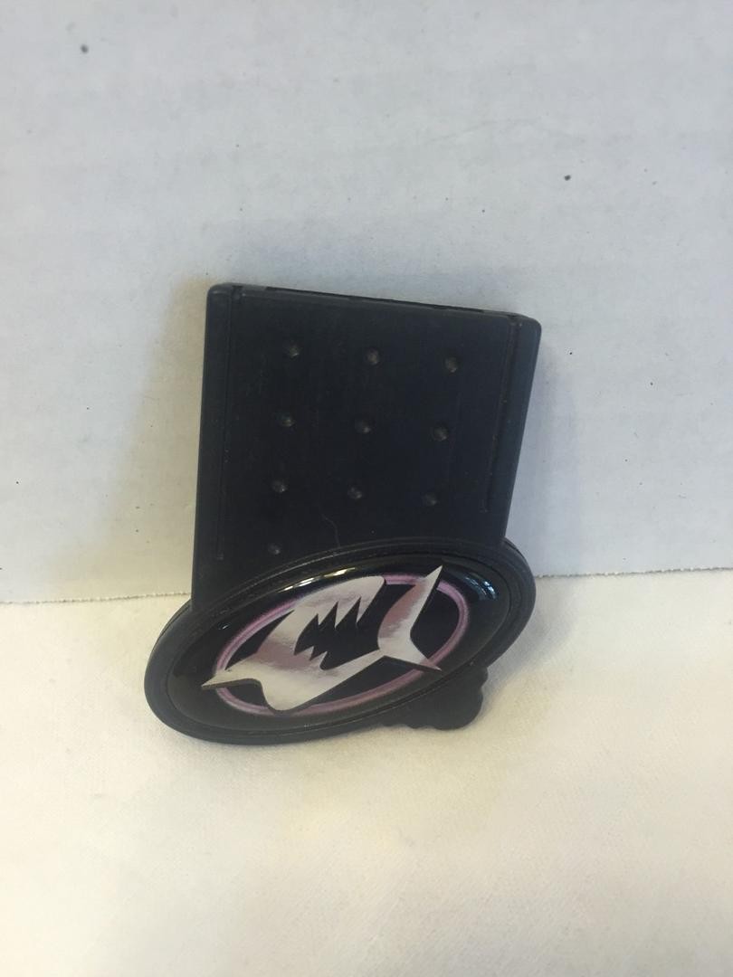

    Cheat codes? GameShark was pretty sweet back in the day.
    I can't remember which version I had (it's been 17 years), but it came with a disc and a memory card like this one to store and add codes.
    It worked perfectly fine on the PSOne

    That dongle in the picture is from the Game Shark CDX. Mine is version 3.3 and works great on the PSone models. There's another "Lite" version which is disc only and will use your memory card to store new codes and configuration so make sure to have two blocks on the player 1 memory card available.

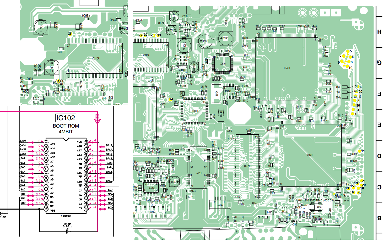

  17. TriMesh
    Jul 3, 2008
    2,324
    Generally speaking, those 8-bit wide SST chips use the same flash algorithms so providing the chip is identified it should program.
    One thing to watch out for is that the flash mapping isn't direct 1:1 for 256KB carts. The original Action Replay only had a 128KB ROM and was mapped with the flash at 0x1f000000 to 0x1f01ffff - on the 256KB carts, the ROM was split with the first half at 0x1f000000 to 0x1f01ffff and the second half at 0x1f040000 to 0x1f05ffff
    Basically, A17 on the flash has to wire to A18 on the expansion port if you want to use original 256KB cheat device ROMS.

    Thanks again. The Microchip SST 39F020 is really easy to get hold of cheaply in TSOP, DIP and PLCC32 from RS/Farnell so will try one of those. Just to clarify.. where would they be connecting the /WR pin from the flash rom? Just so it can be easily flashed on the console?
    Also, I traced out some alternative larger points for the data/address lines - excuse the horrible layout. Basically the numbers correspond to the pins on the BIOS ROM, I have excluded CE as we will be using CPU pin 98. The test point for that is rather small but I still found this approach easier than soldering directly to the BIOS ROM.
