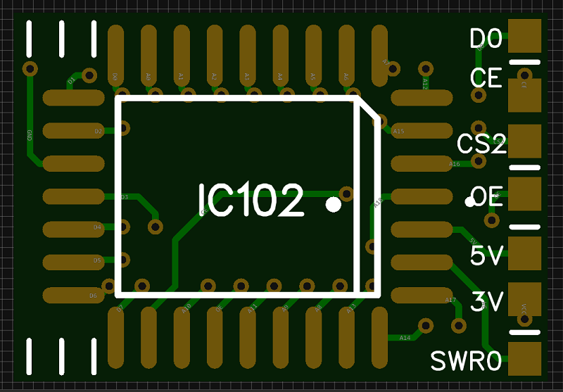

    I made some PCB designs for using TSOP32 and PLCC32 EEPROMS, I tested these - yes, they work. I started all that about 4 mounths ago, there some PCB changes up to that day. There are about 15 mobo's I upgaraded this way already.
    The 4 thing I cared about are:
    -Support all points that modchip use (D0, CE, OE) - for PLCC32 mostly;
    -Support 3.3/5v VCC (for PLCC32);
    -Support dual BIOS installation (IC102+Caetla for example on PSOne);
    -Support X-Flash to be self-reprogrammable (as Dreamcast);

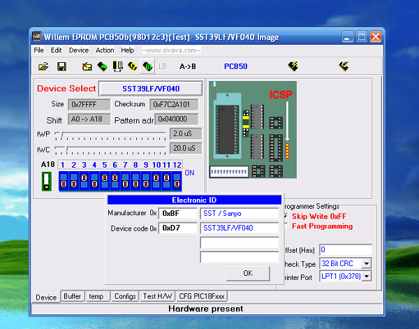

    To flash my IC's I used Willem programmer, pretty cheap. The first thing I did is flashed retail BIOS, next one is PSX-XBOO. Work.
    PLCC32 adapter tested with AM29F040 (3.3 or 5v VCC). It can be CE (0 or 2 dev) configured to be flashed by X-Flash 1.2 (but I didn't test it still).

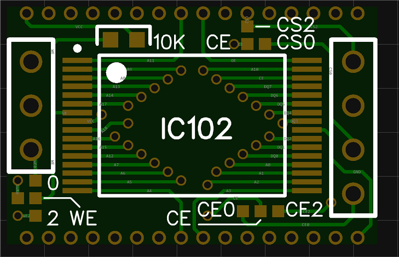

    TSOP32 adapter tested with SST 39VF040 (3.3v VCC). Thats the main design I wanted to be dual BIOS support but it seems like X-flash can't work with such EEPROM. it see my DEV0 EEPROM and shows it's ID values (that match with ID's that Willem shows me), but it won't flash it (can't go to ROM list). Pretty sad. As far as I know there is no source code for X-Flash 1.2 tool, so there is no way to add new ID's there. Probably. Hope I'm wrong.

    P.P.S. I ordered both TSOP32 and PLCC32 PCBs as cheap as possible (17$ cost plus 8$ shipment for 30+30 PCB's). I didn't use half-plated custelated holes, it's pretty expensive option. But I tried to place border lines as much as possible to these holes, they became half-cutted anyway but not edge plated:) For both designs I used 0.8mm PCB thickness. Ordered from JLPCB.
    There are some screenshots, photos and gerber files.

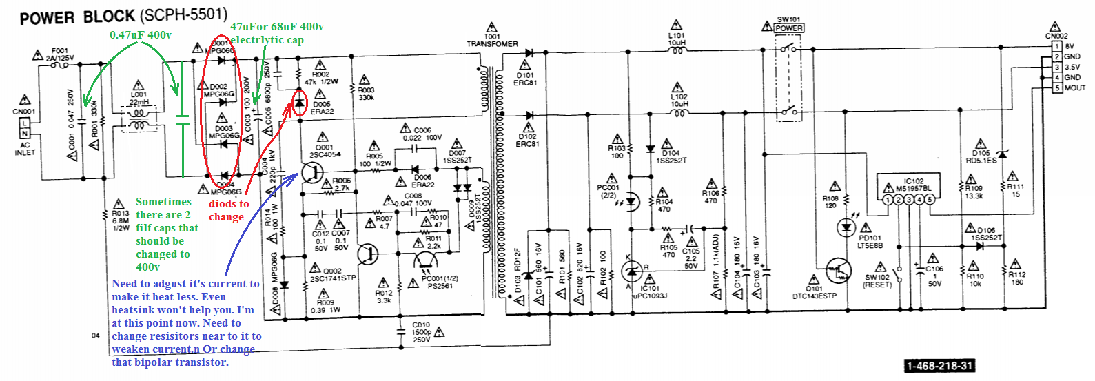

    Yes, these 110V PSU is a big problem. Actually I made them work with 220v already but there is much heat generates on 1 bipolar transistor. Even with heatsink. Need some time to adjust resistors to weaken its current.
    About TSOP32 pcb. It's more like labyrinth at first look but thats not. All that is for dual BIOS feature. It even gives you an option to swap dev0 and dev2 ic's by just few jumpers or 3 pin switches. Thats why there are headers and that much configuration pads. At least that was degned that way, as I said I'm still a bit confused about custom bios and dev0 working combination. If anyone will get confused by these pads - i'll be happy to explain. Probably, I'll post it's schematics, it will explain my idea (about dual bios mapping, swap etc)
    But if you just want it to use as simple IC102 replacement - all you need is just bridge CE and CS2 pads together. It's to the right of 10k Ohm resistor (0603) pads. That resistor pulls up WE pin of your TSOP32 EEPROM. As TriMesh adviced.

    That's not for Playstation 1 but for Playstation 2 called PSX. It was made Japan only. Just type and search "DESR-7500" and you'll see what it's looks like. I did that mod 220-110 for two of my DESR, works well, but that can't be used for PS1 PSU.
    Read here:
    http://www.psxdev.net/forum/viewtopic.php?f=47&t=694&p=14008&hilit=220v#p14008
    And some schematics bellow.

    Hello. Did you connect (bridge) CE and CS2?

    -39VF040? Forward or flipped pins?
    As TriMesh wrote me:
    AM29LV040B-90EC <- Regular pinout
    AM29LV040B-90FC <- Same thing, but with the pins flipped
    I use EC, a regular pinout.
    -Is it getting warm (IC) after powering up PS1? That could be if GND and VCC connected wrong, swaped between each other.
    -Better to check every pin to be soldered correctly using multimeter. I am pretty sure that this PCB works cause I made it work already, both of these designes works actualy.

    Thanks for all the support. your the best! i took another look and got it working. it was a problem with the "half holes" they became hole holes on one side in manufacturing. Befor installing i had to cut one side.
    after redoing this i succeded.

    @Oakleaf Sorry for that, that's all up to complex PCB design. To make J-consoles to just work fine there are no need in these select pads (CSx, CE...) Just wanted to make PCB's as configurable as it could. I'll suggest you to try PSX-XBOO BIOS from no$psx. I'll attach it bellow (for 256 and 512kB IC's, our is 512). That BIOS lack of PS1 famous boot screen but there is no need to use modchip, PSX-XBOO can handle on it's own. Try it.
    P.S. Oh, yeah, I'm using capton tape, I put it on the bottom of the PCB adaptor. It really helps no to short any of these holes by accident.
