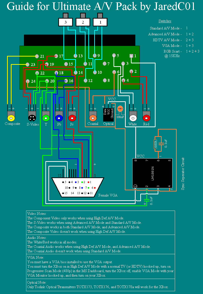

    Question: can someone with an actual Chihiro and a multimeter test the AV cable and tell me how it's wired? I've attached a pic for reference.
    Are 9+10 connected or open?
    Are 11+12 connected or open?
    Are 13+14 connected or open?
    Thanks!
