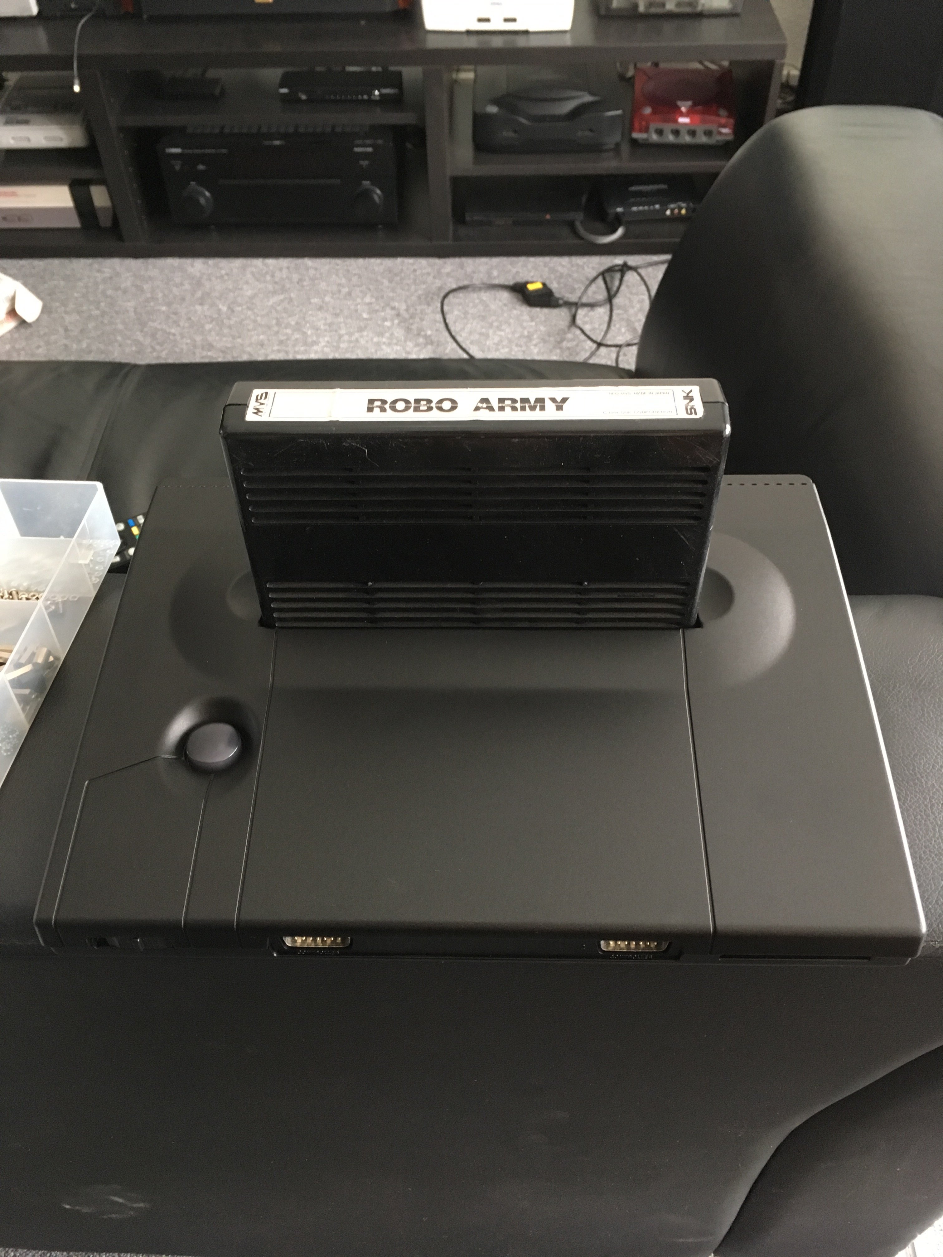

    So a little over a month ago I bought a MV-1C and started gutting the system, and today I picked up the shell after painting it a few days ago. Everything has turned out pretty well I think :)
    Painted and assembled:

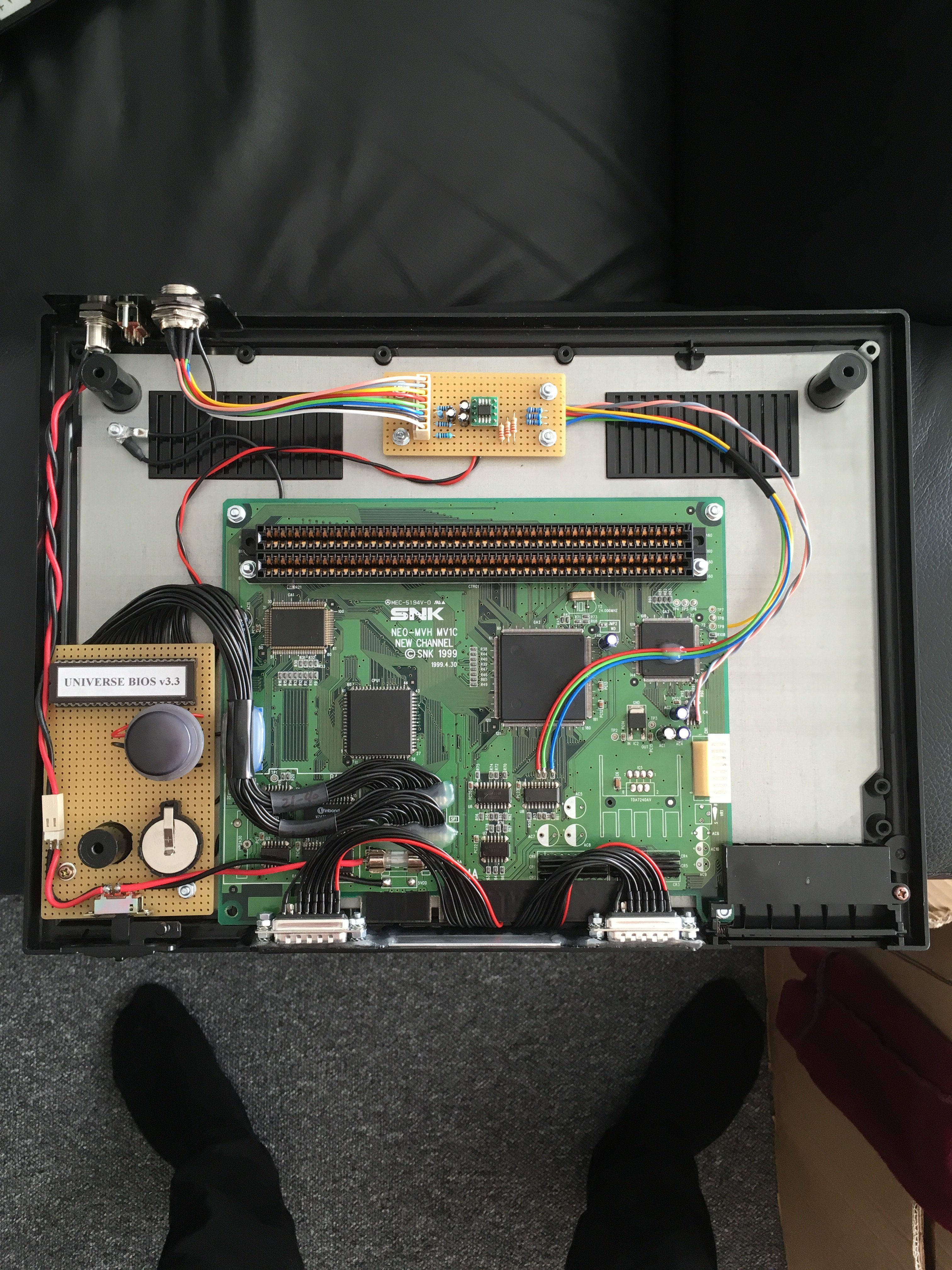

    Here's a picture of the inside:
    - I tried keeping everything as neat and tidy as possible. The system can be taken apart without having to desolder anything, which is always nice :)
    Caps were replaced, Unibios installed, White LED light added to the reset button, and a new rechargeable battery was added.
    I just need to add the Dual Frequency Oscillator mod, so this thing can run in proper 59.94Hz rather than the obscure 59.18 it does by default. I have all the parts already, I'm just waiting for the PCBs I ordered :)

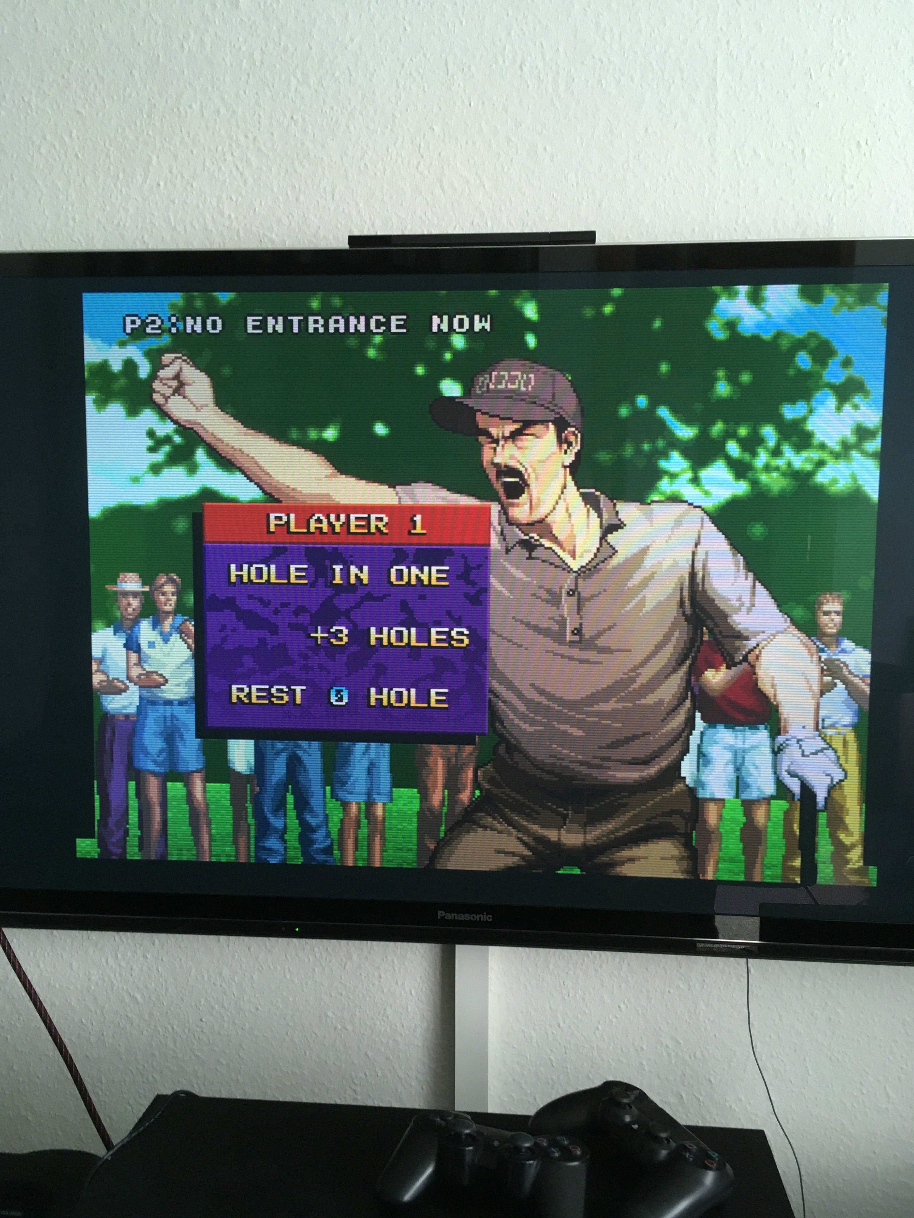

    Here is a video of me powering it on:
    https://www.instagram.com/p/BK0oARrAAkN/
    Let me know what you think :)
    Also, Hole in one! :O

    Way out of my league but very inspiring work nonetheless! Kudos! Is it connected via a Framemeister? The image is very crisp.
  12. Bearking
    Bearking Konsolkongen
    Aug 2, 2010
    856
    100
    Yeah it's running through the Framemeister :)

    Feb 27, 2014
