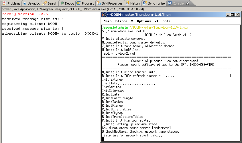

    I've picked up working on this again. I am implementing "network" multiplayer using the USB port on the 64Drive to communicate with a network bridge based on ZeroMQ. I'm working out the communication protocol now and have stubbed out the USB send/recv in the 64Doom codebase. If the Everdrive 64 allows programmer access to send and receive data over USB, I should be able to implement it for that cart as well, and it would be compatible with the 64Drive version out-of-the-box seamlessly due to the PC bridge interface being identical for any platform that can send and receive arbitrary buffers of data over an arbitrary comms interface to a PC. More soon.

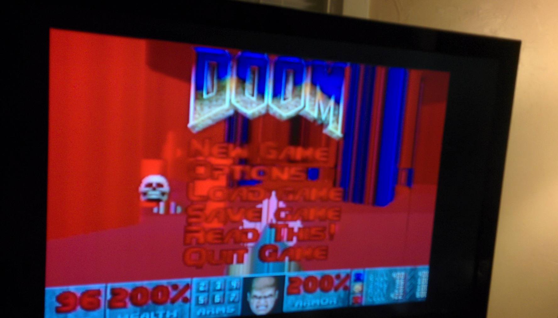

    Not in a way that will be enjoyable. In order to get functioning multiplayer working in 64Doom I had to hack it into the original iD GPL-release Linux Doom code. To get that playable I did a bunch of code hacks to make it build in Cygwin. To test it, you have to run Windows in 256-color mode to force Cygwin/X server to run in 8-bit color mode and the color palette doesn't work correctly so it looks stupidly ugly as in the attached screenshot above. Also there is no sound.
    I needed to get it working on the PC side as quickly as possible for development and testing purposes, so those issues will never be resolved.

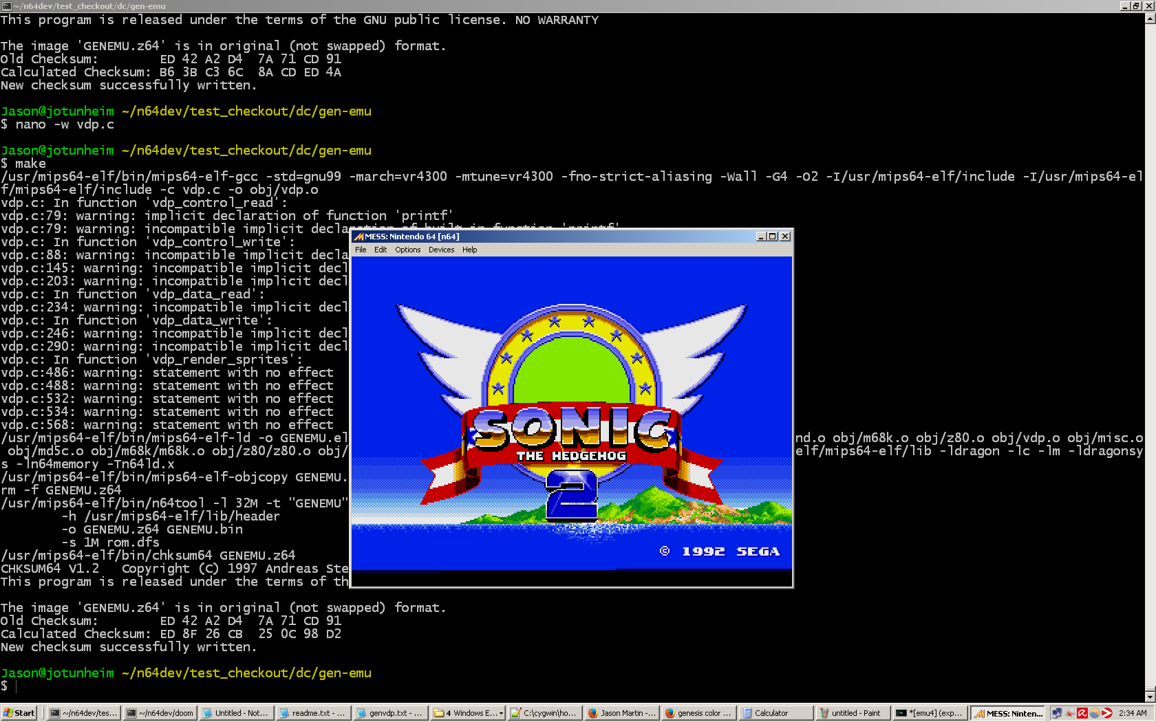

    I got bored so I did this.

    Note: This is never going to be a real project with a release. I needed something to refocus my energy because the 64Doom networking stuff was going nowhere. I ported Genesis emulator code I wrote for Dreamcast in 2002 to see if it works. Sprites don't and it runs at seconds per frame. Just a late night boredom diversion.

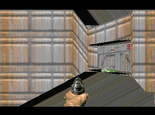

    I'm currently working on a PSX Doom style hardware renderer utilizing the RDP.
    I've intercepted the Doom rendering core (R_DrawColumn / R_DrawSpan) and will use the information provided through their setup to hardware render with the RDP a textured quad for each column and span to be drawn. These quads are all 1 pixel by N pixels in dimension (N wide for spans, N tall for columns).
    My first test to make sure I had hooked in the correct places software-rendered a solid colored line onto the screen using the first color of the pixel for all columns and spans. I've attached three pictures. The first two are taken from MESS. The first was columns only, the second both.
    The third is cell phone camera snap of it running colums and spans on a real N64 on my TV.
    I am now working to implement RDP rendered solid colored quads per column / span to mimic the software rendered examples above. I will then add textures into the mix.

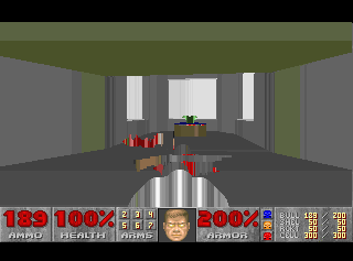

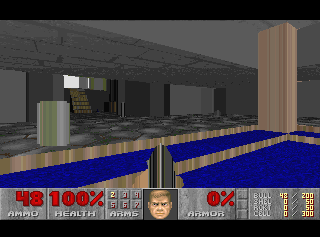

    Software-textured quads for columns and spans.
    Do not have scaling accounted for in the columns yet. Getting completely wrong texels in the span textures currently and also not scaling it properly.
