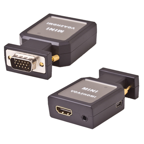

    I have a hanzo & I use this converter. (Only supports 31khz mode, also the hanzo powers the device so the USB cable isn't needed)
    This outputs at 640x480 & your TV will upscale the image. (Since anything displayed on a 1080p screen is upscaled regardless of the input)

    The device supports all main PC resolutions, but it's not an upscaler so it only outputs what the source tells it to.
    I have a samsung 46" smart TV & it ups the video to 1080p (input is 640x480, what's displayed is scaled to the panel resolution, in my case 1080p) I also have it in PC Mode, so the dreamcast controls the RGB colours & it looks cracking.
    Quality will also depend on the type of VGA adapter you have I have both the hanzo & the cable variant, I can tell you the hanzo looks f@#%!ng brilliant, the cable not so much. (The cable has what can only be described as, the Abrams lens flare effect on white surfaces)

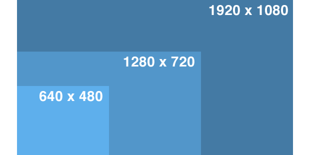

    I give up, you clearly don't know how HD flat panel TV's work. (ie, LCD, Plasmas, AOLED eg...)
    Anything displayed on your TV is upscaled to the panels native resolution, so that could be 1280x720 (720p) or 1920x1080 (1080p).
    The input resolution is completely different from the output (input is what the TV receives, output is what you see on the screen with your eyes, this is upscaled to fit your screens horizontal & vertical, native resolution. (1080p display, 1920x1080)
    Look at it this way, if your TV never upscaled the image you would have a tiny 640x480 box in the center of your screen. Basically if it fills your screen from left to right or top to bottom it's being scaled.
    If you don't want to believe me, go look it up. (Really you should have done this in the first place)
    Here is an example, of no scaling. (Or what you would see on your TV if it wasn't scaling the image)
