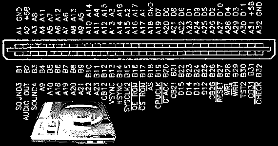

    I did some test last night but it is still not working.
    Maybe this information would help to understand where is the problem. NBA JAM(original MD cart) boot fine but after the 3/4 screens with developer advertising it stop on a black screen.
    This game is not working with the adapter
    i checked the three pins you told me, MD B31 is connected with at B30 Megatech and this to me is ok becuase If I connect it to B31 to B31 or not connected the Everdrive don't start at all.
    MD B19 is not connected at all, i tried to connect it to Megatech B19 but this doesn't help.
    MD B28 i am not sure at all, It is connected to Megatech B28 but i don't know if this is right.
    I builded an adapter like this by my self too, I used a guide a guy gave me some time ago, the adapter I build works fine with the games i tested, like the original adapter, but this has more pins connected, the original adapter really use few pins.
    I would like to shere with you the Megadrive and Megatech pinouts this guy gave to me and I used.
    Some pins are ok and are working 100% some others I am not sure ant that guy was not sure too.
    Maybe you are so in Magadrive stuff and you can find the wrong pins
    marco

    this it the megadrive pinouts he gave me and I used for my adapter:

    here is the megatech pinouts:
  13. mar.vetto
    mar.vetto Rising Member
    Oct 7, 2011
    53
    A1 to A32 pins are the same as Megadrive so they have been just connected directly.
    The most important pins and the pins I am not sure are B16 B17 B18 B19 B27 B28 B29 B30 B31
    The problem is on these pins...but where
    marco

    probably you do something wrong, because b30 on mtech is a for sms mode (if your doc file is right). try to pull mtech b30 to vcc by 10kohm resistor, and b31 connect to b31
  15. Nipedley
    Nipedley Member
    Oct 17, 2011
    15
    Hey, I'm the guy who originally wrote those documents. They are correct to the best of my ability, though you've got me checking through some spare PCB's now to make sure as I also had this idea.
    Unfortunately I blew my mega-tech motherboard during a hardcore sonic 2 session last month, and haven't had the chance to swap a spare in/repair it and so haven't tried out my everdrive in it yet.
    Most of the signals were not changed. B28, B29 and B31 (which seem to be the important ones here) should match up but the adapter you received (I also have one) does not have these connected. It's also worth noting that pin B10 And B11 (Address 21 and 22) are also not connected on that adapter.
    I never managed to find out what B31 actually does, KRIKzz any chance you could enlighten us there?
    When I get the chance to get my mega-tech working again I'll give this a go, if you make any progress also let us know how it goes :)

    i used b31 for access to internal registers of cart, which is not placed in cartridge address space. aslo some games used b31 for switch between save ram and game rom. SSF2 used b31 for bancks switch

    The adapter i am working on is like yours, made with sega magatech soccer original cart as donor and mega drive sonic and knuckles cart socket on top, your guide was really well made....I had just 1/2 indecision...maybe you can meke it clear for me now...
    Pin B27 on megatech you call CE but I don't find any CE on mega drive pinout
    Pin B17 on MD you call CS this is not clear too
    I am very happy to find you out i tried to speak with you on Arcadecontrol forum but this was not possible....:pray:

    B28 probably the only possible reason
