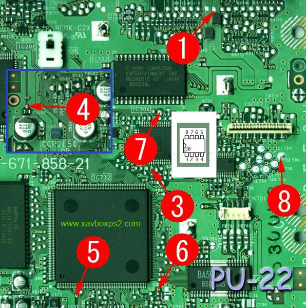

    I've received the PS1 - Mayumi v4. Soldered it according to the diagram in the first post here. The chip has been installed in a PAL SCHP-7502 C.
    It works and loads import games (haven't tried any backup).
    Only problem is that sometimes it goes to the Audio CD menu instead of loading the game. After a reset the game will load just fine.
    Any help on this? is it expected that it doesn't load 100% of the times? I've tried not so many times but I'd say it worked 70% of the times.
    Is there anything I should check in my installation?

    Hi, I've received and installed the Mayumi v4 in my European SCPH -7502 psx according to this diagram.
    It works fine loading jap imports but sometimes (30% of the times) it goes to the Audio CD menu. A reset works just fine, meaning after the reset the game loads.
    Could this be related to a bad install? Is it expected?

    Does it work 100% of the time on a reset?
    You could try adding a decoupling cap to the chip (between pins 1 and 8, 100nf/0.1uf ceramic cap).
    If that works, you probably have a poor PSU or caps in the system.
