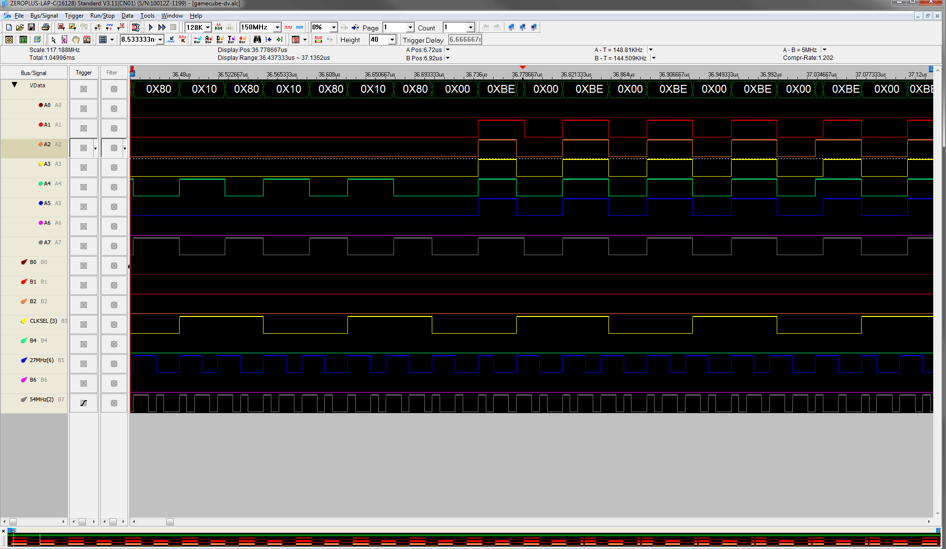

    I'm sorry, but I have to disagree on that. The logic analyzer capture below shows the change in the signal from the active area of the video signal (which is black - luma 0x10, chroma 0x80) to the blanking area. An 8-bit BT.656 video signal would send "0xff 0x00 0x00 <flags>" at this transition, but the cube just switches to luma 0x00 and flags in every chroma byte.

    It's more of a question of how a BT.656 receiver would interpret the codes. From what I can see the GC's flags align perfectly with BT.656 flags, so if GC inserts the codes at the correct time, and the receiver ignores the non-sync bits which have been repurposed, it should be compatible. It's pretty clear that the I/F at least started out as BT.656, so it must have targeted a standard receiver, probably for encoding purposes at some point.
