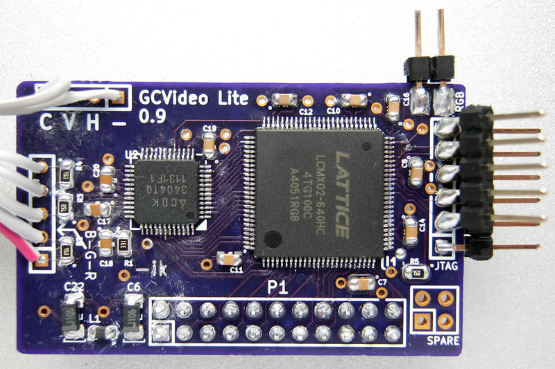

    There is already a jumper (technically just two solder pads) to switch between component (with embedded sync on Y) or RGB (no embedded sync) on the board and a second header always has C/V/H sync signals regardless of the jumper setting.
    Maybe some people haven't found the picture of the prototype board yet:
    The connection along the left side is the video output (three signals with ground pads between them), sync signals are on the header on the top left that is marked "CVH-". The Component/RGB jumper is on the top right, the headers pointing to the right are JTAG for programming the FPGA. Yes, I should've cleaned the board some more before taking that picture.
