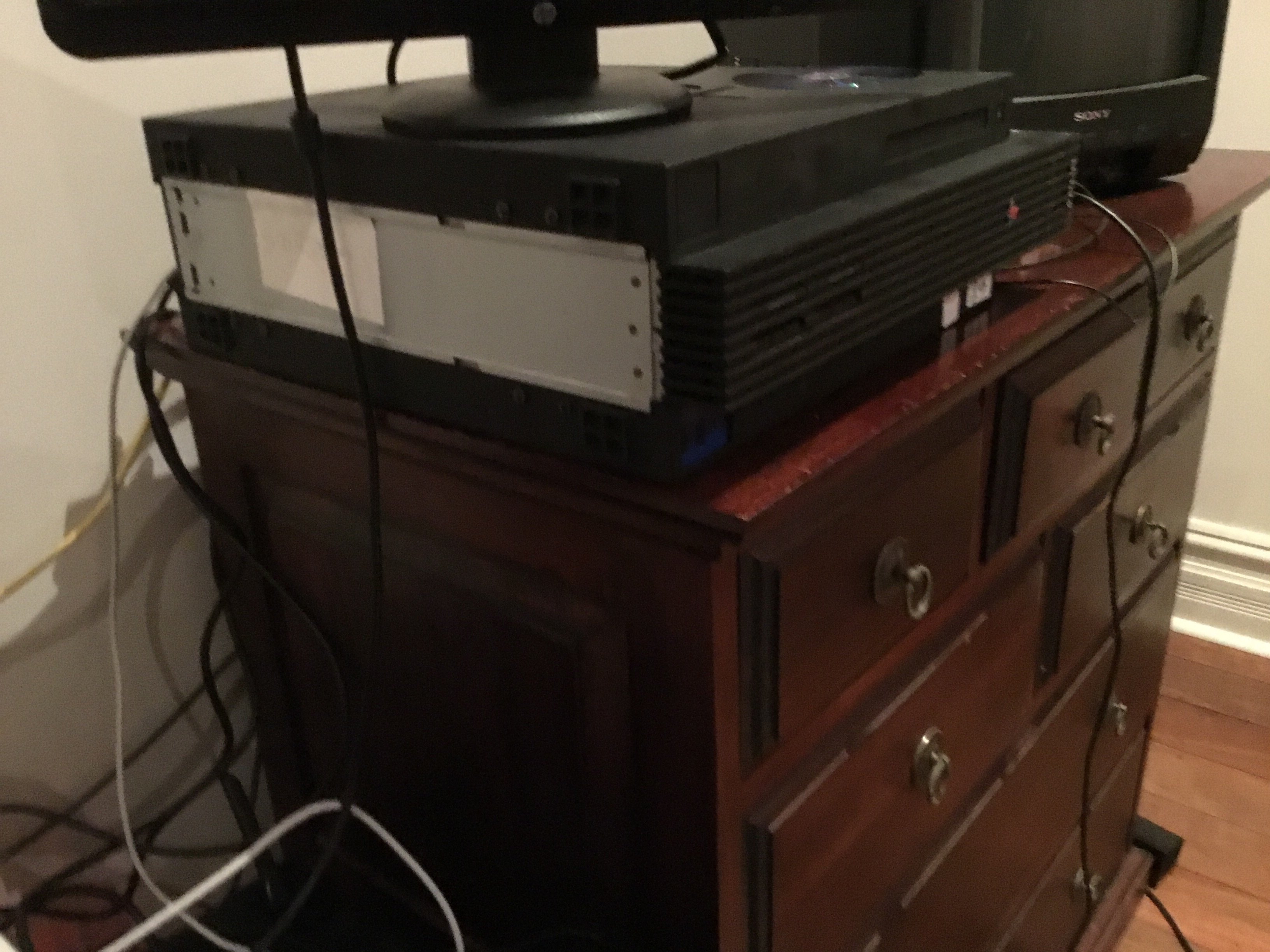

    This guide will go over:
    1. Password Reset
    2. IP Config
    3. Running a game
    Video:
    Text:
    Some Tips:
    1. Use the VGA Port on the card at the bottom of the TOOL in the card expansion bay/ The VGA under a metal shield/cover (If your unit has it still screwed on)
    2. DO NOT EVER pull out the VGA on ANY old computer whilst it is running - It can short-out/zap the Video Coder - I have killed a computer back in 2003 like this - It does happen.
    3. Don't handle the unit by holding the "Mohawk" and "Front Facade." Handle the unit by holding it's rear and under side (When I reference the top of the unit, I mean as if the unit is placed vertically and the "top" is where the on/off and reset buttons are located)
    4. Be very gentle with the Memory Card slots - the plastic covers are extremely delicate (they're made from plastics - some dated back to 1999, the metal/tin rods are extremely brittle)
    5. You don't need a transformer - the TOOL supports 110V-240V at any frequency used in your houses AC
    6. If you unplug the PS/2 keyboard you may have to reboot the system for it to work again (Also off topic fact - If you punch a PS/2 Keyboard you can actually completely kill a computer - I had a friend when I played LAN parties in 2005 bash a keyboard and kill the computer like the USB killer does xD)
    7. You need a PS/2 Keyboard - USB keyboards don't work.
    8. The USB ports on the front of the TOOL are for the PS2's hardware, not the TOOLs
    9. Check to see if your Ethernet Cable is plugged in properly - (I spent a day trying to figure out why my net console wasn't working)
    10. If you have the TOOL placed horizontal make sure the TOOL Logo is facing up/visible. (So the CD/DVD drive is accessible and the HDDs are running in the recommended orientation)
    11. When selling a TOOL, be careful how you package it - make sure that you have heaps of bubble wrap (Thick Types) and use Biodegradable Packing Peanuts.
    12. DO NOT EVER TURN OFF THE UNIT VIA POWER WHILE IT IS RUNNIG (If I hear a TOOL dying that that I'll die of disappointment)
    13. If you take apart the system, use the guide on the other thread
    14. You don't need both the HDDs you only need the 1st one (The second one was supposed to be used with the DTL-T14000 CD/DVD Emulator)
    15. DO NOT change the dip-switches on the rear of the TOOL - See the SDK documentation for what they do before changing them!
    16. Make sure the dip-switches on the front of the TOOL are set to, "TOOL" and "DVD."
    17. Make sure the TOOL can breathe and is well ventilated (Some systems can get up to 100 degrees C, it doesn't really matter but still, I'd die if I hear about a TOOL dying from lack of cool air -on the owners accident-)
    18. If you have a DTL-T15000 You're lucky - Your TOOL is a Performance Analyser and can be used with the Performance Analyser Program in the 2005 SDK to show how games are using the system and developers can make their games run way more efficiently by utilising the PS2's Hardware better.

    You have a weird way of removing the Tool's stand...
    port187 likes this.
  7. Joshuawthomson
    Joshuawthomson Active Member
    Aug 18, 2017
    37
    I used two different screwdrivers because I placed my unit horizontally. In the next video I will show it with the stand removed completely.
