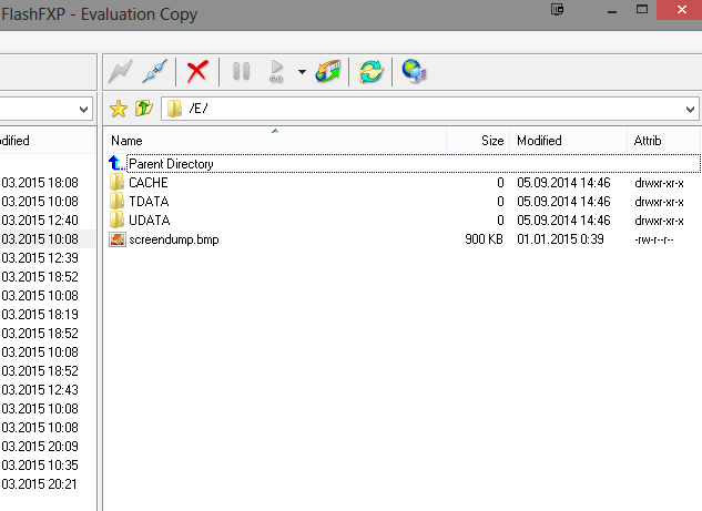

    i played driver 3 about 2-3 hours yesterday and it worked fine. its defenitly something wrong with temp sensors or OS. may ignore it or change dashboard. but how to change? i got xbox with simple microsoft dashboard, after a year xbox was flashed to evolution X.
    can u say how to switch to Microsoft Original Xbox Dashboard from EvoX?
    ive connected to xbox using ftp sever but cant find any dashboard files
    screenshot

    Take a screenshot of the C partition please, like you done for the E one above.
  14. alexeymakarov
    alexeymakarov Member
    Mar 12, 2015
    Its empty. All drives are empty except E.
  15. HEX1GON
    Softmod with ShadowC. I suggest you don't touch it then.
