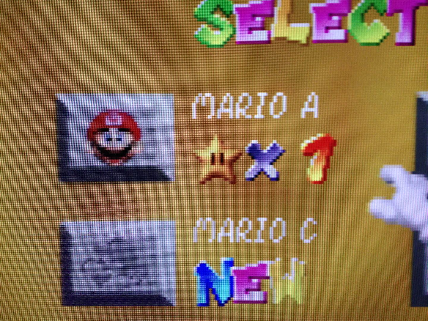

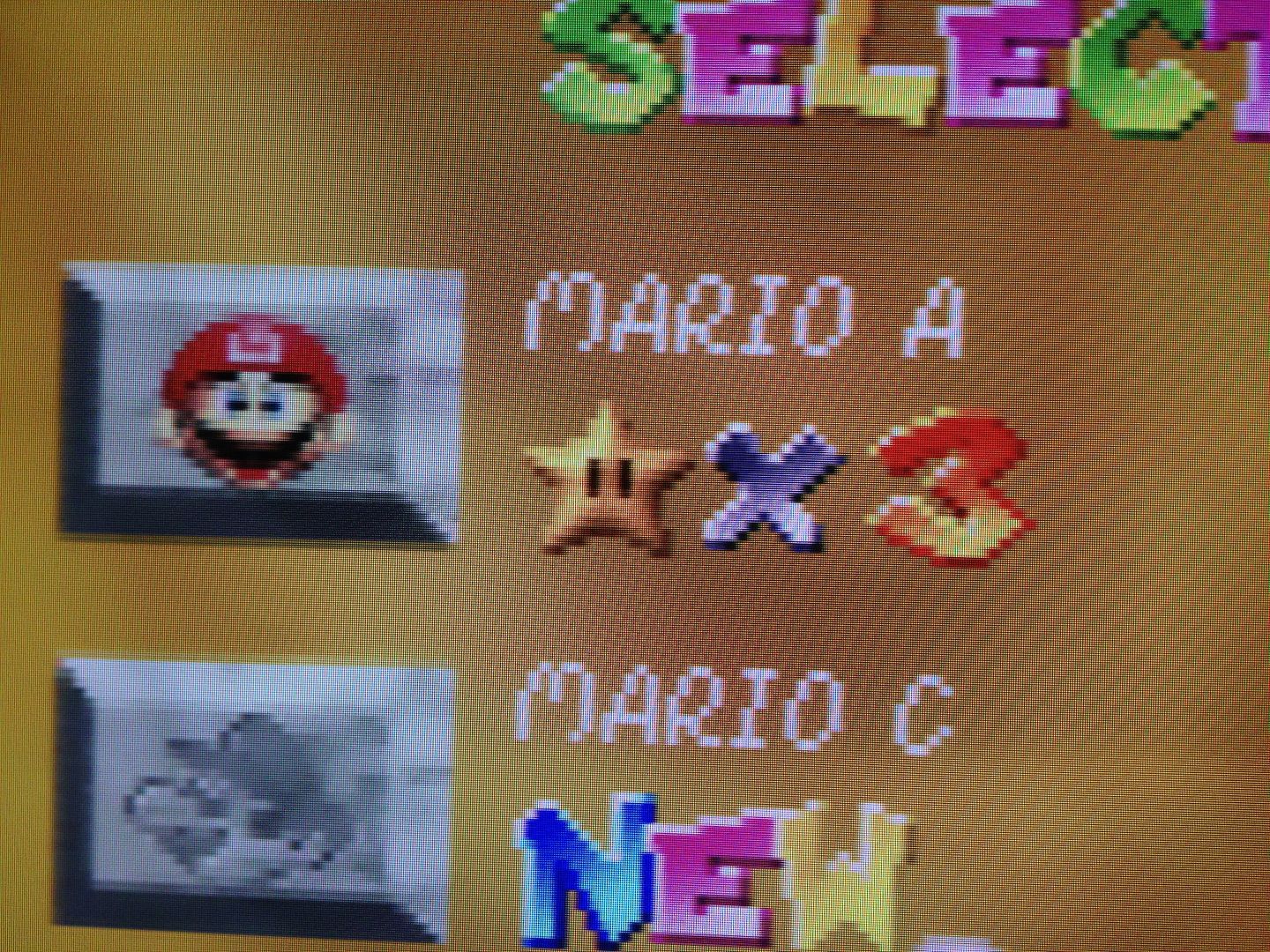

    You should build this amp instead of the THS one:
    http://playoffline.wordpress.com/mod/n64rgb/
    It's a bit better, as in sharper. I tried them both a few weeks ago.
    THS amp:
    http://i40.photobucket.com/albums/e...CE-9891-740B24DD84E8_zpsnhdatzvc.jpg~original
    Transistor amp:
    http://i40.photobucket.com/albums/e...28-8406-60BEF0194608_zps0ojctv2d.jpg~original
    Look at the top part of the A in "MARIO". In the THS shot the top part of the letter is noticeably softer. Both shots taken with my XRGB-mini set to 720p (because I normally use scanlines). It might seem like a really small improvement, but it does make a noticeable difference when looking at it from a distance as well :)
