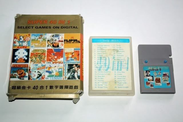

    I remember playing a pirate cart like these ones, except it had a couple switches of the on/off variety to determine which menu you got.
  17. Trenton_net
    Trenton_net AKA SUPERCOM32
    Apr 13, 2007
    2,378
    58
    There are many types of GB pirates. Some use DIP switches to bank the different games, some use the power switch (if I recall correctly, where you turned off-on the power quick to swap games), some used a button which cycled over the games, and some didn't need any of that.
    In any event, GB pirates are pretty common. I have quite a few for collectors purposes, as well as Chinese Original GB games as well.
