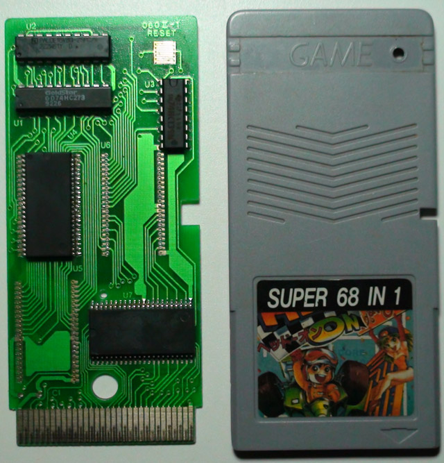

    Sorry for picking up a relatively old post, but ever since someone showed me those weird carts, I had to get one !
    This one came up on eBay 2 weeks ago:
    Seems to be another (earlier) version from the same manufacturer: the exact same chips are used and there's also 4 spaces for ROMs, but no die spots for COBs. Those ROMs are 1MB 8/16bits stuck in byte mode, they're in a weird through-hole TSOP-looking package but have the same pinout as the 27C800's.

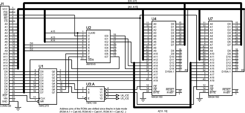

    Here's the schematic:
    As far as I can understand, the PAL can only differentiate 4 write ranges:
    $0000~$1FFF, $2000~$3FFF, $4000~$5FFF and $6000~$7FFF which are all in the ROM space.
    Some of the games included in the cart originaly used the MBC1 mapper to switch ROM banks.
    Since the biggest games are 128kB (8x 16kB banks), the PAL only "emulates" the lower 3 bits of the original $2000~$3FFF MBC1 range.
    Those are the IO1/2/3 outputs of the PAL going straight to the A16/A15/A14 of the ROMs (probably reversed to simplify the fusemap).
    The other write ranges match the ones for the RAM configuration of the MBC1 (which no included game use), so they're used for other things:
    One range clocks the 273 latch and is used by the menu for sure, selecting one of the 4 possible ROM chip (bits 4/5), the 128kB bank number in which the game's first bank is (bits 0~3), two other bits for the PAL to add a 16kB bank offset to pack games <128kB (bits 6/7).
    Not sure what the other 2 ranges do, maybe there's just only those 2.
    Will dump the menu code next week to see what bytes are latched to start each game.

    (Edited that last schematic, ROMs are 2MB and writes to the PAL are just $2000 and $4000. The menu code is a mess and runs from RAM, but isn't voluntarily obfuscated.)
