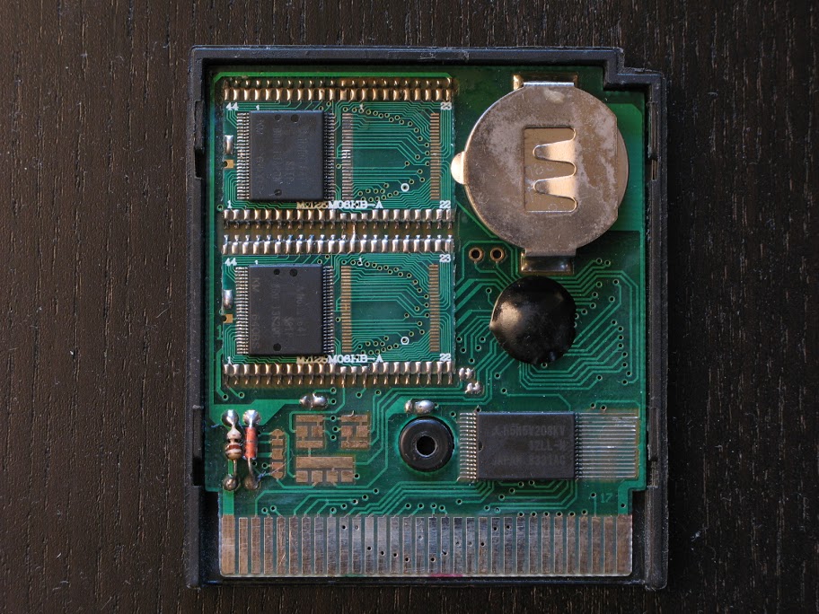

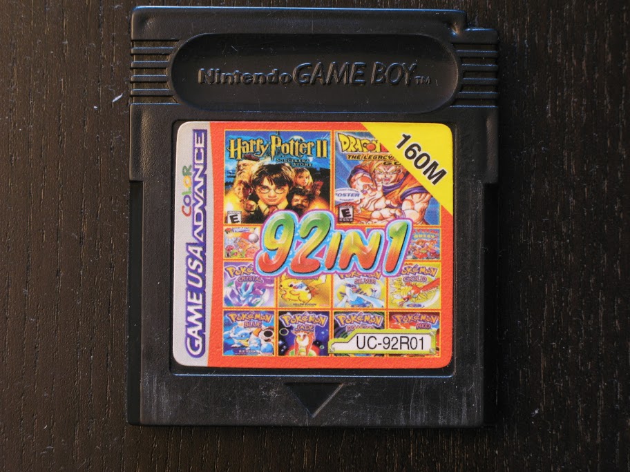

    Hello guys,
    Actually this topic is a good way to introduce myself.
    I've been willing to post about a pirate cart I got not so long ago. This one has been manufactured much later than the ones displayed here.
    The cart claims 160Mbits and 92 games which is almost right...There are 92 unique games but I only counted 144 Mbits
    There are 2x64Mbits Flash TSSOP m6mgt641s8tp and one m5m5v208kv-12LL-W for the backup ram. From what I read on the datasheet, the m5m5v208kv-12LL-W is 16Mbits and not 32Mbits.
    I believe these carts were manufactured at a time when Flashcarts where already flooding the market and were cheaper to produce than the regular ones, the same kind of xxxin1 I've seen on the NDS.
    Now the question is: can this cart be easily modded to turn it into a real Flash cart?
    I guess the blob is the menu and can't be reprogrammed to adress the proper locations of the roms we would hypothetically store in the Flash, so it'll have to be bypassed.
    Calpis, if you're reading ;-)

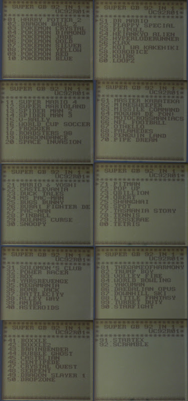

    Now here's the most interesting part maybe, the full listing of the games:

    The blob is the mapper chip.
    The menu is usually on the first "block". I had an broken multigame cart (Zelda games) which I hacked into a vanilla Tetris cartridge.

    Thanks for your input l_oliveira. So the menu just send the corresponding adress for each game to the mapper that bankswitch the correct game?
    Let's say I can write on the Flash and want to make my own multigame, does it mean I just need to modify the jump locations in the menu accordingly?
    If you have documented your hack, I'd be curious to read ;-)

    There will be a MBC-like mapper, then another mapper on top of it to handle the higher bankswitching (or ROM offset) and address masking. You can check whether the cart is programmable without reworking by tracing the /WE strobe from the flash. I believe GB linkers use the audio pin on the connector for this purpose.

    Hey Calpis,
    Glad to see you here! I'll try that indeed.
    On a side note I got confirmation that the article will be published in the october edition so I need to translate it and send it to you asap ;-)

  19. mdmx
    mdmx Familiar Face
    Nov 3, 2005
    1,300
    my cart contains the following games:
    Tetris
    Mario Land
    66 Pinball
    Qix
    Seaside Volley
    Burger Time
    Bugs Bunny
    Castlevania
    Navy Blue
    Quarth
    Spider-Man
    Lock'n Chase
    Burai Fighter
    Solomon's Club
    Shi Kin Jyo
    Pac-Man
    Super Tank
    Flipull
    Mahjong
    Klax
    Loopz
    Lode Runner
    Macth Mania
    Alleyway
    Puzzle Road
    Amida
    Pala Medes
    Korodice
    Dragon Slayer
    Dr.Mario
    World Bowling
    QBillion
    Space Invaders
    Pitman
    Tennis
    Snake
    Flappy Special
    Tasmania Story
    Trump Boy
    Penguin Land
    Hong Kong
    Pipe Dream
    Ishido JPN Ver
    Volleyfire
    Soko Ban
    Koi Wa Kakehik
    Battle City
    Heiankyo Alien
    Shanghai
    Mine Sweeper
