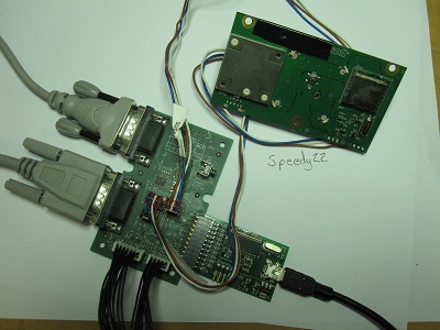

    This is the full lamprey setup. It will not shoot gold nuggets out your arse!
    Without the addon boards NAND flashing will only work on what I call engineering prototypes and some early devs. Lamprey alone will only provide Kernel debug on Non retail kits. Certainly not worth $1100 .
    Alittle 360 hacking history - It was used to reverse engineer the 360 SPI so any device that has that capability can do the samething.

    Is that seriously a MS borad? the addon

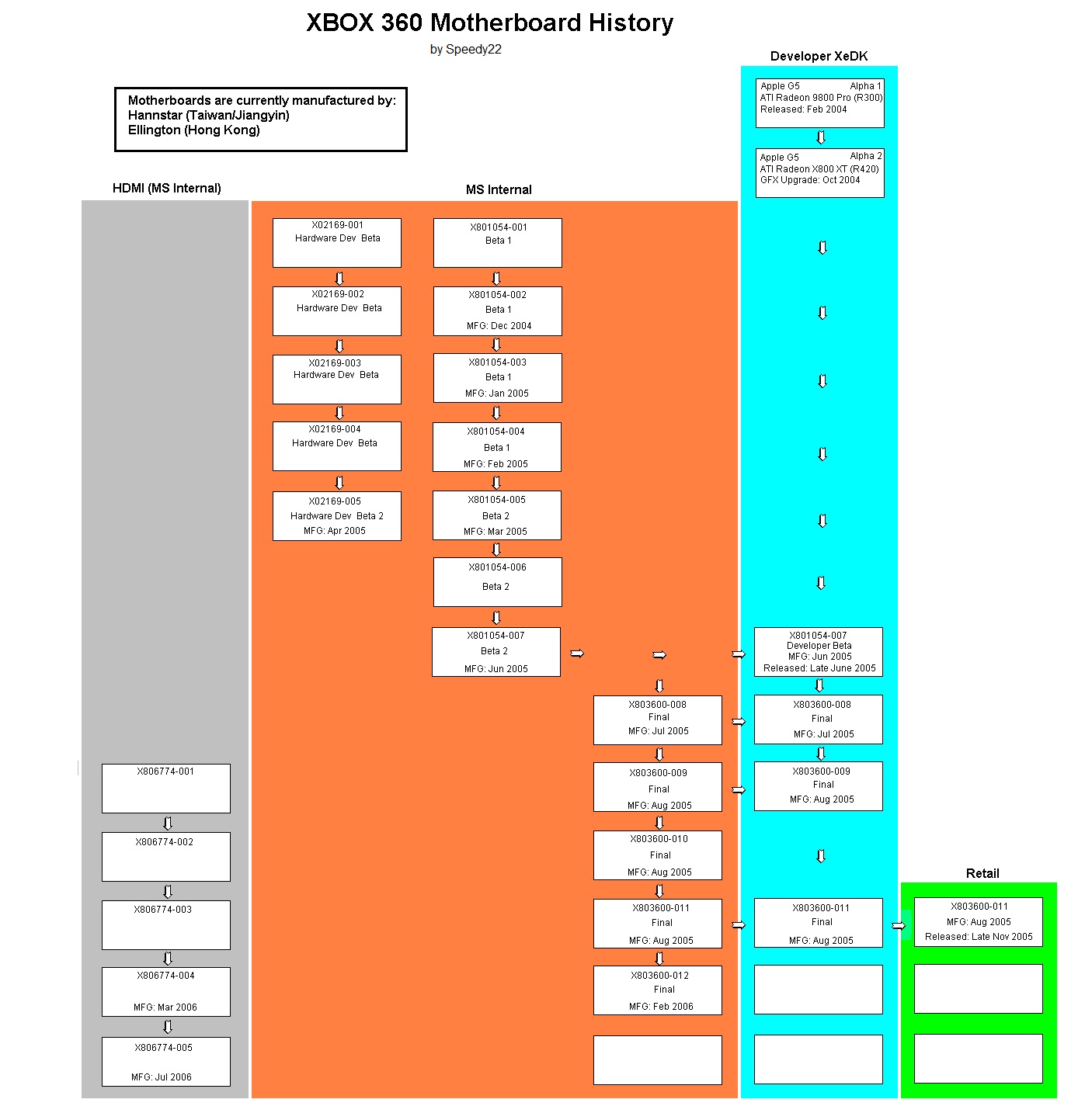

    Im more curious about that xenon 012 board...

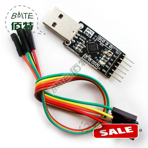

    @@@@@LOOK!!!!!!@@@BUY_RIGHT_NOW_SAVE@@@UNBELIEVABLE@@@@LAMPREY for less then $3 USD including shipping!!!@@@@@@
    Here you go, lamprey for less then $3 and it's USB to boot. http://www.ebay.ca/itm/USB-2-0-UART...C_Drives_Storage_Internal&hash=item564571ffb4
    Anything simular will work.
    360 header J2B1 or J2C3
    Connect $3 lamprey gnd to 360 header pin 12
    Connect $3 lamprey TXD to 360 header pin 1
    Connect $3 lamprey RXD to 360 header pin 2
    Set the baud rate to 115200, 8N1
    Launch Windbg (look on the net for installation instructions)
    Power up your 360 Dev and you're kernel debugging.
    S22
