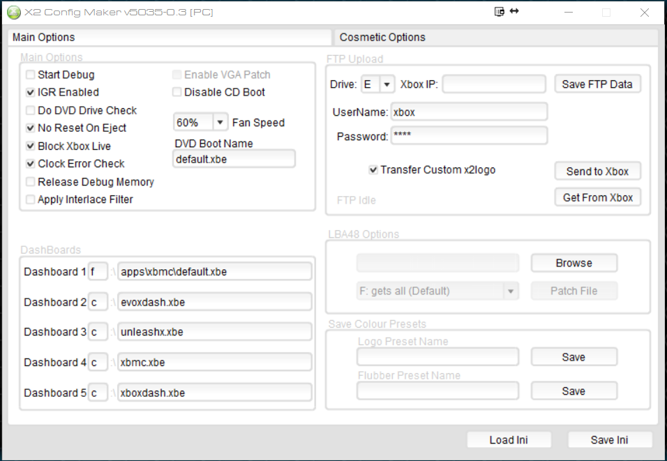

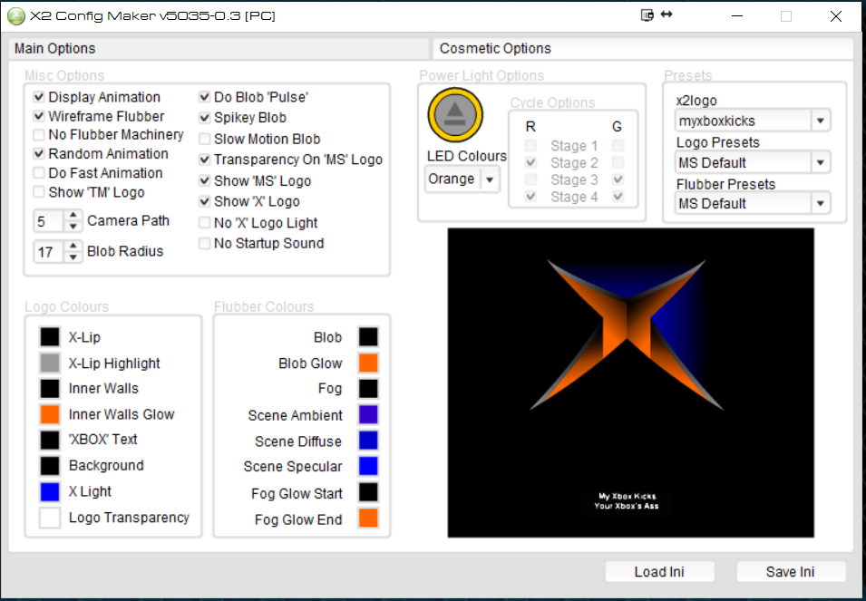

    You can use a 512k version of X2_5035 on all xbox's if you have a chip with at least a 512k bank on it. There is a 1.0-1.5 and 1.6 version of the bios.
    I would stick to X5035, M8 or iND-BiOS but X2_5035 is my favorite since you can edit the bios options on the fly with a handy program called X2Config Maker, it even has a built in FTP that will send the edited config file to the xbox for you.

    I thought X2 5035's BIOS had no FTP server it'd been removed.
    --edit--
    I see it's the X2 Config Maker that has an FTP client to upload or download the x2config.ini file to/from the Xbox via the replacement dashboard's FTP server.
