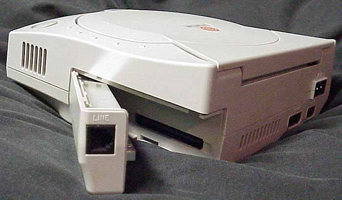

    I have a stupid question.
    I am aware of the current GD-Rom Emulators that are available, GDEMU and USB-GDROM Controller. Which is great! :)
    Early models of PS1 had the Parallel IO Port.
    And currently PSIO is successfully developed to take advantage of the port. Which means, user could both use SD card or their Original Games with out replacing the CD-Drive Unit.
    My question is, why developers have not took advantage of the Communication Port that is on the side of the dreamcast? Could a device be made with SD Card that is similar to the concept of PSIO that does not replace the original GD-ROM?
    Since a broadband adapter was made, the Communication Port was capable of sending and receiving data at
    10 and 100 Mbit speeds.
    There could be a loader program burn on disc. Users could access the data from SD-Card via a that app. Since All models of Dreamcast has the communication port, this device would work across all models!
    I am not sure if this idea came up before or not, but it just crossed my mind. Just sharing with this dreamcast community.

    551
    because of ext port and gd-rom drive are on the different buses.
    ext port is on the G2 bus, unlike gdrom-drive is on the internal G1-bus.
    it's possible to make device on g2bus, and load games from dreamshell w/ additional driver for such bus.
    g1-bus gives a way to direct hardware emulation of gdrom-drive.
    ps1 PAR port share most generall signals lines w/ cd-rom controller. so it's good point to attach cd-emu through PAR -port. anyway we need make mod, add two lines.
