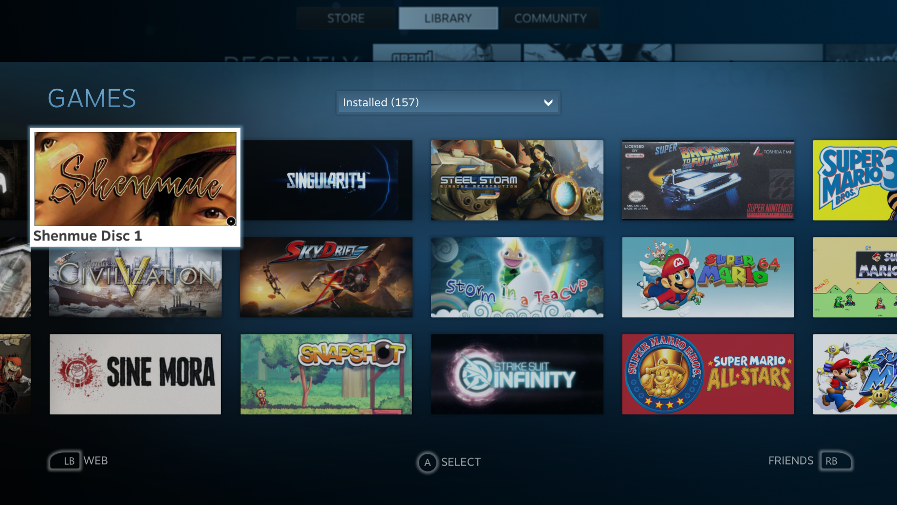

    I agree with FamilyGuy. That to me would be the most user friendly way, and that way the "Dreamshell OS" is always the default boot image. I will be honest, I haven't used Dreamshell since 2011, but when I did use it, it felt clunky, and somewhat slow, but that doesn't mean I didn't like it. People were making DS-Icon games/apps that you could launch from the desktop just like if it were a PC. That to me was pretty impressive.
    I would just like something a bit more flashier and faster to navigate.
    For instance, something akin to how the dashboard in Steam Big Picture Mode looks with grid images of each game fully navigable.
    Notice how I have Shenmue Disc 1 emulated and launchable from within Big Picture mode. It took quite a bit of work writing batch files and turning those into exe's for Steam to launch, but in the end it looks nice and is worth it. I was imagining something like this but as smooth to browse as DC Playa is to navigate.
    Edit: Sorry for the full size screenshot, I uploaded as attachment and thought it would auto resize.

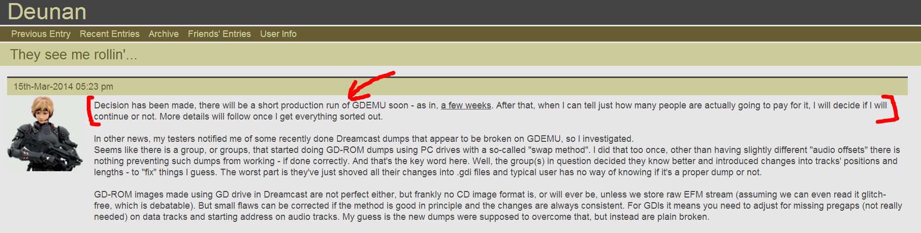

    Huh, don't know how I missed it, but Deunan has stated he will make "a small production run."
    Does anyone have any thoughts about this?
    For one, is anyone intending to purchase one if they are indeed made available?
    Why or why not?
    -a2a
