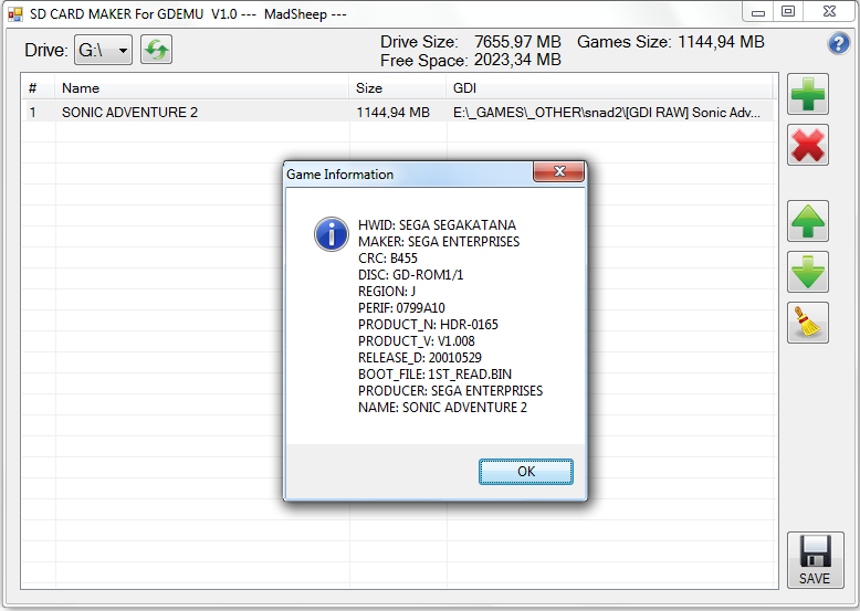

  17. madsheep
    madsheep Peppy Member
    Jul 19, 2013
    313
    78
  18. OzOnE

    @madsheep - nice looking software there. Good to see some work being done for the DC still.
    We are looking at using Dreamshell as a front-end for the DCIO atm, but it's very likely that we will write a much simpler menu which will load super-fast from power-up.
