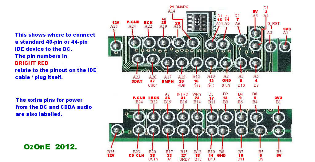

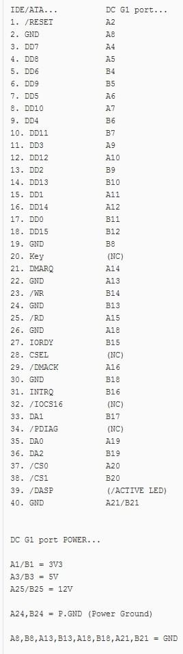

    If I wanted to cut the end of an IDE cable off and solder each wire to the Dreamcast individually... would the wires be in order 1-40 starting with the red wire? Can all the ground wires be connected to a single point?

    You need the pinout and solder 40 pins + dreamshell ready bios... is that it?

    Just compare cable with DC-Swat schematic - Red/Blue wire is 1st pin, last wire is 40th pin.
    And cable...
    But I have another question for one who already did this: Is DC PSU capable to power 3,5" HDD? According to pinouts we have +5V and +12V but won't it burn PSU/Mobo?
