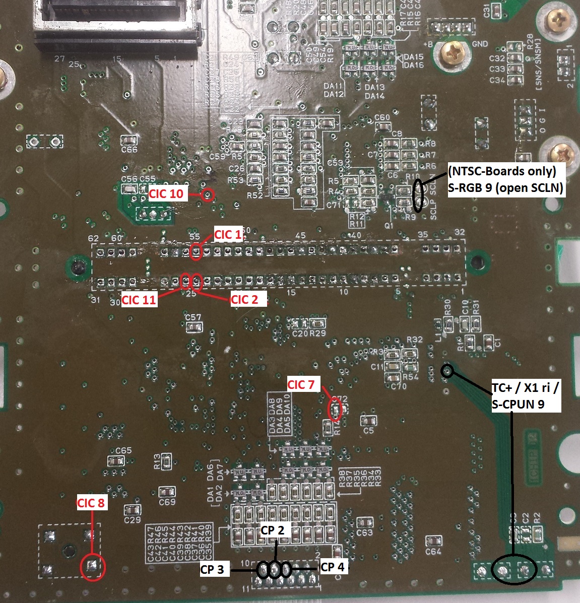

    Some loosely remarks to the testers of the last posts and the testers in general ;)
    - If the CIC is removed, you may also remove C9, too
    - CIC 1, 2 and 11 can be get directly from the cartridge slot pin 55, 24 and 25 (same order)
    - CIC 8 is the reset button (lower right pin on 1Chip big model consoles, upper left on SNES Mini/Jr.; downside of the mainboard, controller port is down, MultiAV up)
    - CIC 10 is reset out and connected to S-APU pin 100; in 1Chip big model consoles, there is a via directly in front of the pin (follow the trace just 1cm)
    - CIC 7 is connected to S-CPUN 122 (if I have it correctly in mind). On the 1Chip big model there exists a place for a cap on the downside of the mainboard named C72 (NTSC console) or C74 (PAL console), where you can get CIC 7 (left solder point with the via next to it)
    - the signal at CIC 7 is the equivalent signal as on cart slot pin 56 (clock for the CIC-key). You may want to use this pin instaed of CIC 7
    - (NTSC 1Chip big model consoles only) S-RGB pin 9 is connected to a jumper called SCLN. Just scratch up the connection there and connect the left pin
    Hope, these remarks help to reduce installation errors :)
    TriState294, Bearking and Helder like this.
  14. keropi
    keropi Familiar Face
    Feb 2, 2011
    1,068
    64
    maybe this will help, made it back then when I installed borti4938's board , you can see the CIC, GND/VCC, xtal and joypad points :
    Bearking, Helder, sa1 and 1 other person like this.

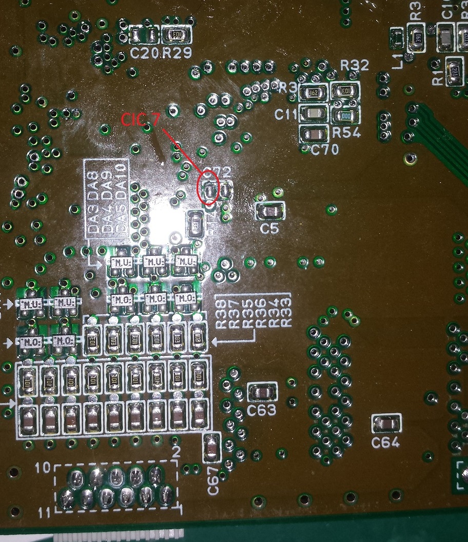

  15. malcolm
    malcolm Rising Member
    Jan 10, 2015
    54
    thank you! again a great source of information. just tested cic7 to left side c72 on NTSC 1chip-02 and indeed it has continuity to cic7
    Helder likes this.

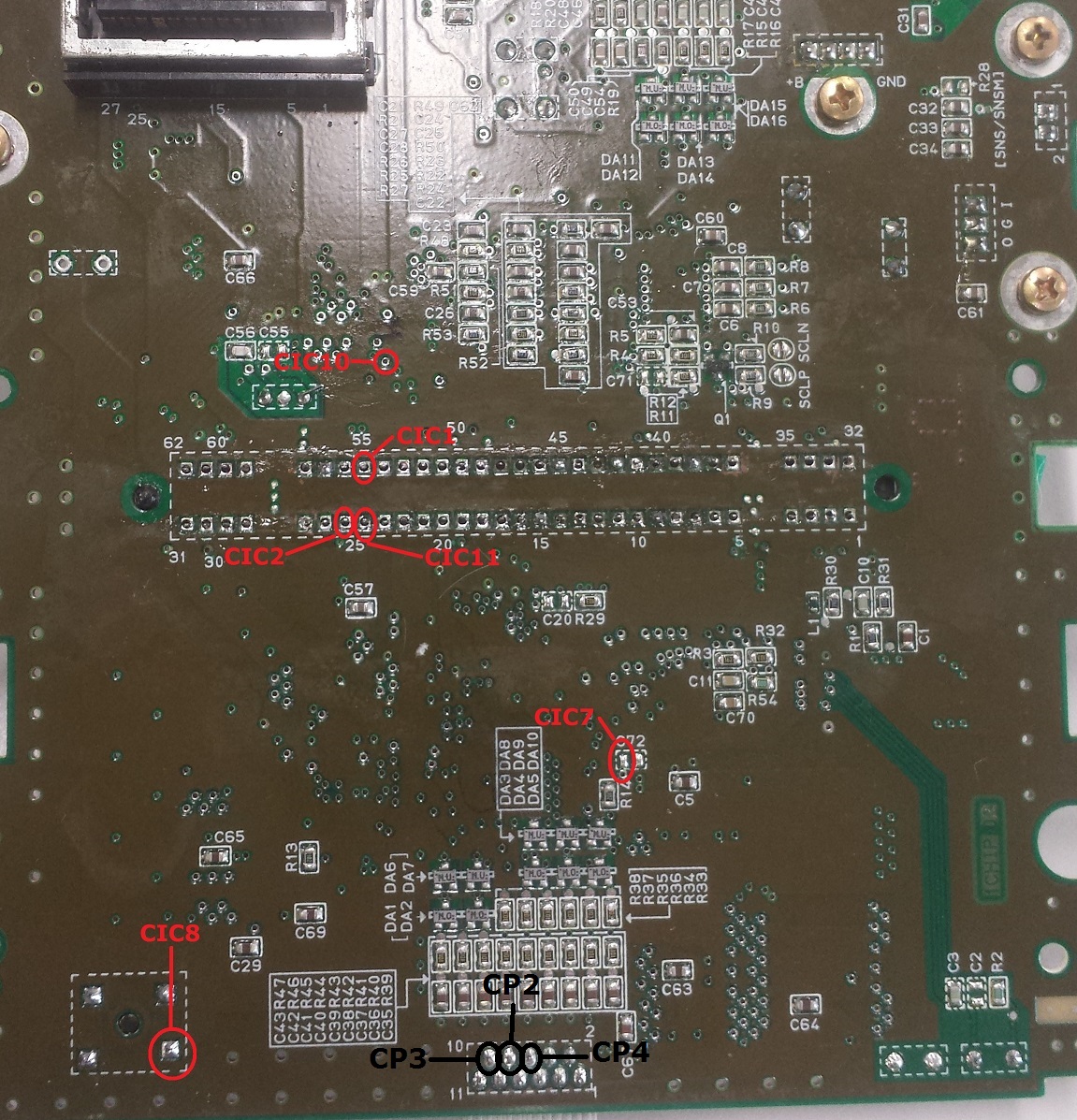

  17. malcolm
    Jan 10, 2015
    54
    Following on from borti4938 information. Here is a picture with marked locations for alternate cic points. Might make installs easier.
    removed image corrected in post below
  18. borti4938
    borti4938 Robust Member
    May 8, 2014
    205
    64
    CIC 2 and 11 are in incorrect order. Just change it ;)
    Edit:

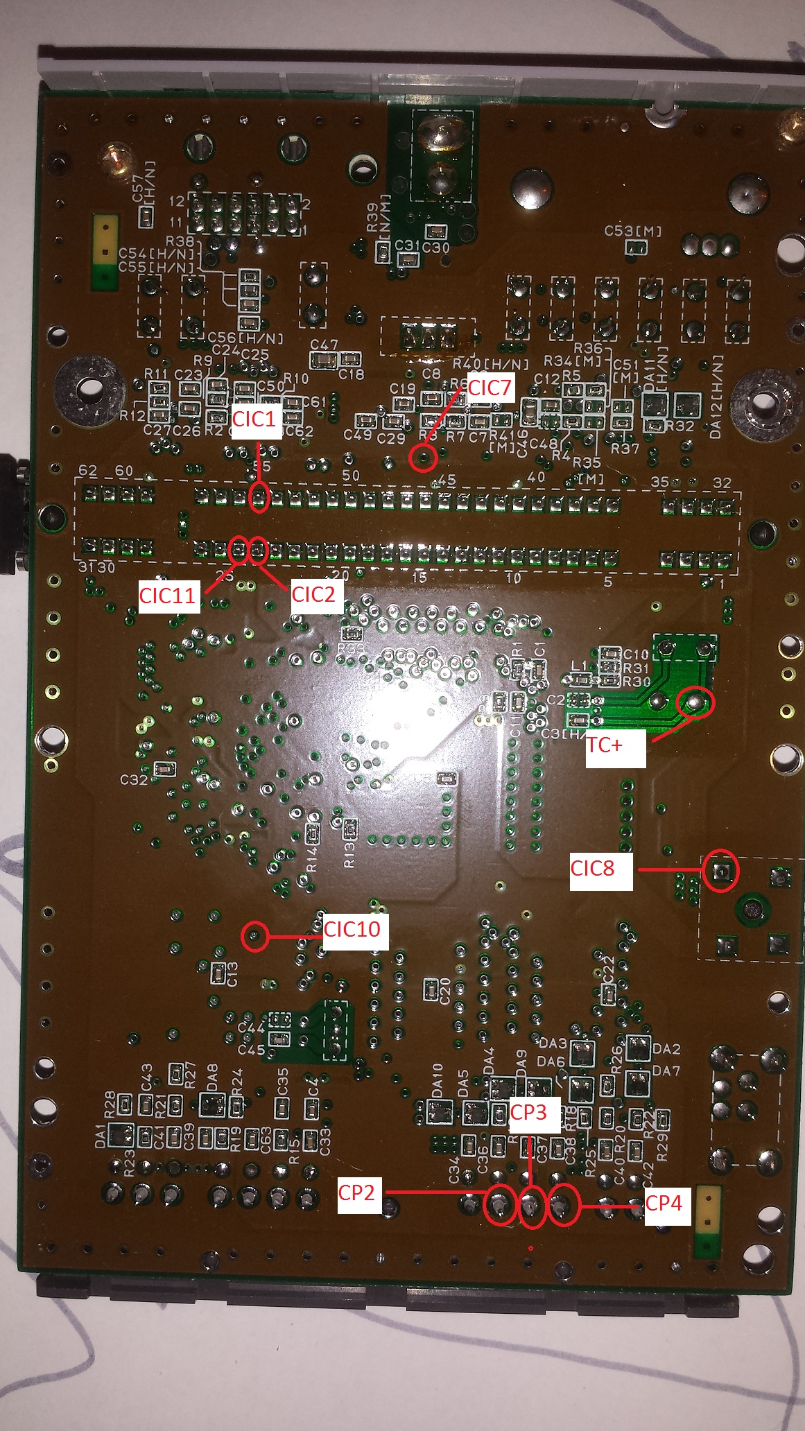

  19. malcolm
    Jan 10, 2015
    54
    SNES mini alt cic locations
    Edit: changes made to reflect advice from borti4938
