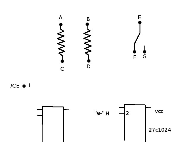

  9. GOREFESTOR
    GOREFESTOR Rising Member
    Dec 22, 2010
    69
    40
    Very well, I'll be find good resistances.
    I prefer to feel like an idiot, but I need more precision because I didn't understand the whole.
    In my little picture you can see the letters point, easier to explain
    Either I seriousely doubts for the pins of the MPR TSOP original chip, Are they the same that the 27C10214 ? If not the /CE is in pin 2 or 12 ? And VCC(+5v)
    Thank you very much for your help Oliveira.
  10. l_oliveira
    l_oliveira Officer at Arms
    Nov 24, 2007
    3,879
    245
    Join A and B connect to +5v
    Join C and F connect to BIOS 1 chip pin 2
    Join D and G connect to BIOS 2 chip pin 2
    connect pin 2 that comes from MD board to point E at switch
  11. GOREFESTOR
    Dec 22, 2010
    69
    40
    This can't be more clear for my little brain :) Thank's a lot.
