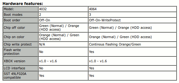

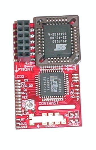

    Photo of Aladdin XT 4064.
    Aladdin XT 4064 (aka xenoFX) and XT 4032 were originally released by Xeno Team back in 2004. The board (PCB) used for both of these models were the same, which confuses people these days when only clones of AXT 4032 using the same board are available, LCD footprint is still there for POT and pinout, etc, but no functionality to support it.
    The Lattice LC4064 CPLD code is indeed different for AXT 4064, compared to AXT 4032 which features a Lattice LC4032 CPLD.
    I have this chart from launch day which explains it a bit better.
