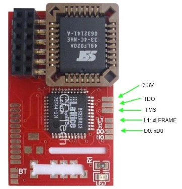

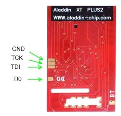

    if i build a JTAG programmer, how do I connect the Aladdin xt to it? I don't get it when you said(Solder leads on the 6 programming pads of the Aladdin XT)

    A JTAG programmer connects to 3.3V, TDO, TMS, TCK, TDI and GND. The other pads labeled are the same on the top and bottom side of the PCB for connection to the Xbox when installing the modchip.
    AladdinXTplus2 JTAG Pads (Component Side).png AladdinXTplus2 JTAG Pads (Back Side).png
    Three (3) of the JTAG connections are on the component side and the other three (3) on the back side of the PCB.

    There are 2 different devices to program on the Aladdin XT plus 2 for the Aladdin_XBlast modification.
    The TL866A is used to program the SST49LF080A with the XBlast OS (.bin file).
    You also need a JTAG programmer to reprogram the CPLD (Lattice LC4032V) using files named with the SVF (Serial Vector Format) extension (.svf). The JTAG programmer connects to 6 pads on the right side of the modchip - 3 on the top side (3.3Vdc, TDO and TMS) and 3 on the bottom side (GND, TCK and TDI) of the PCB.
    All of the instructions are in the archive and discussed in bennydiamond's first post in this thread.

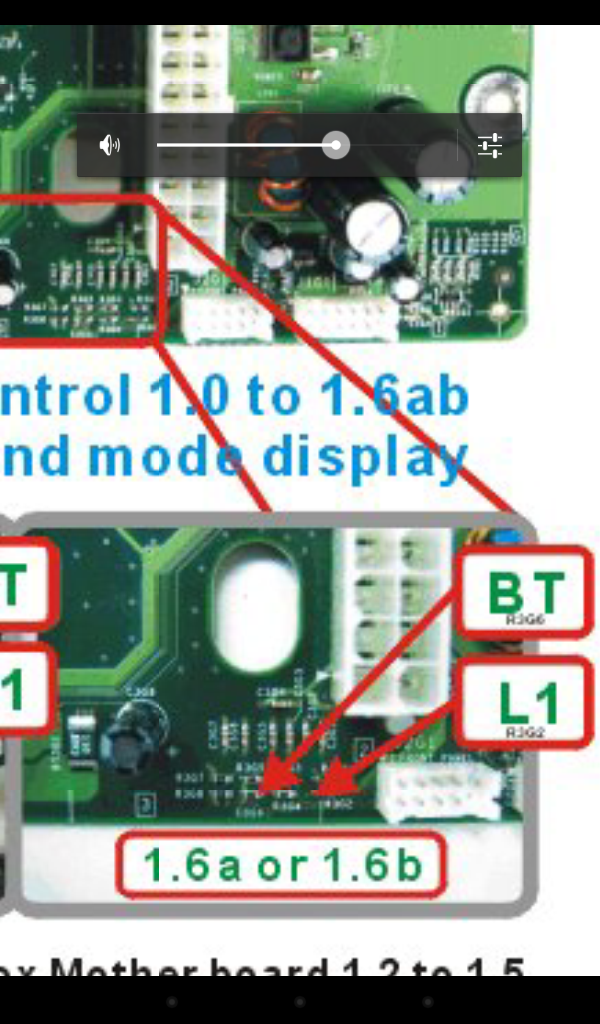

    • looking at the image I uploaded.
    • how do I wires these?
  18. bennydiamond
    bennydiamond Gutsy Member
    Aug 24, 2011
    476
    180
    Correct.
    For the flash chip, you just need to program the upper 256KB of the SST49LF080A to begin with, the rest will be used by hacked BIOS images you can then flash using XBlast OS. If you're not sure, you can mirror XBlast OS to 1MB and flash the entire chip it doesn't matter either way.
    I only provided the SVF for Aladdin XBlast mod but it doesn't matter. The JED is basically the binary dump alone while the SVF is like a receipt for programming the CPLD. Running the SVF will check device ID, erase, program and verify against the embedded JED in the SVF. Lattice own tools as well as urJTAG can handle SVF just fine.
    They are not used with Aladdin XBlast. Only wire required is d0 (1.0 - 1.5) or L1 (1.6 - 1.6b).
