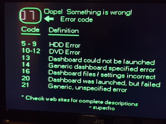

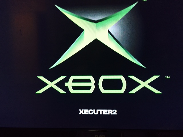

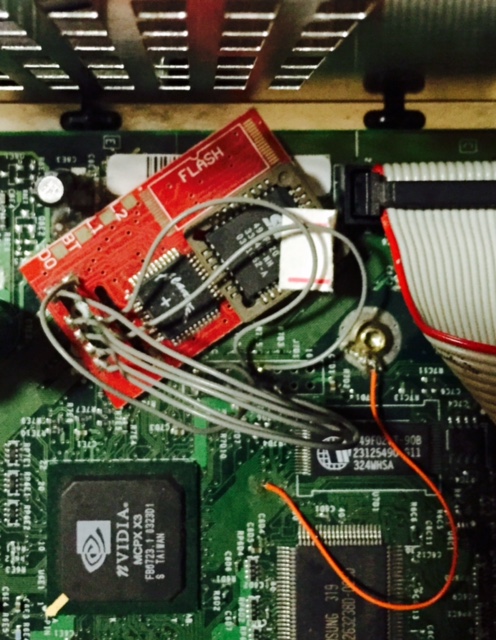

    I'm either getting a Error 7 or it sticks on the loading screen (both pictured below as well as my ancient mod chip). I read that error 7 was usually the ribbon being loose, so I checked then replaced the ribbon...same problem.

    Code 7 is for HDD timeout, means its either not spinning up in time, not able to be read or the cable isn't seated right. if you've re seated the IDE cable and or replaced it and it still doesn't work and you've confirmed the HDD is spinning up then the HDD either has failed and needs replacing or it has a horribly slow spin up time and if that is the case you should allow the xbox to get to that error screen and then turn it off and back on quickly it should hopefully boot.

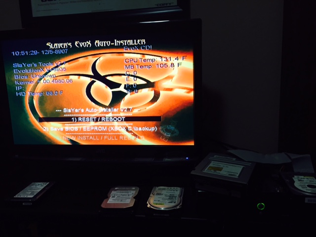

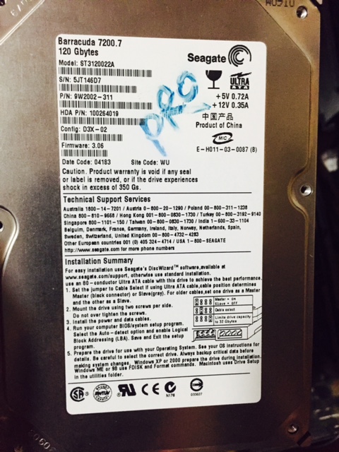

    Sorry, I should have tried before asking. I placed another xbox hard drive I had and..I got error 6. Then for the heck of it, I put a band new IDE hard drive I purchased to upgrade one of my softmodded xbox's and.....(see picture below). Unfortunately it's past midnight where i'm at and I've never used slayer before and want to see if this is what I need to format a hard drive from scratch as I believe. Will give it a shot tommorow but at leass i'm IN! Thanks. FullSizeRender (5).jpg

    If you put a new IDE drive in, you'll have to make a new build. Last selection from your screenshot. Or bootup AID in the DVD drive, and let it do it's thing while following it all on screen.

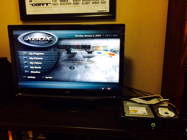

    Thanks, Have it all up and running now! Tonight before I go to bed i'll start FTPing Coin Ops Massive over, throw a ghost case on it and one of the Kids (in thier 20's) XMas gifts will be done. Glad I had this old one with a mod chip in it lying around. FullSizeRender (7).jpg
