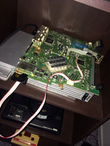

    That's the xFlash device I was talking about. It can be software-accessed, even in PS2 mode, with iomanX, PFLASH and PXFROMMAN. It screams "Free xFromBoot me !" lol ;) .

    The PFLASH module provides low-level access to the flash device, so it also allows the 64Mbit NAND chip to be easily dumped and flashed. No actual hardware hax even needed.
    If I am not wrong, XFROMMAN seems to be based on MCMAN. So its functions are not totally unknown.
