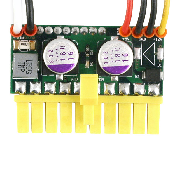

    Uh dude, you missed what I'm talking bout completely. I know the pin-out for ATX, I know the color codes and voltages. I was talking about the standby line that is powered even when the PSU is in an off state. That is what gives a PC and the Xbox the ability to power up from a simple switch on the motherboard. IT has a little power going to certain points even when powered down. Difference between Xbox and normal ATX is Xbox has a 3.3 volt standby line whereas ATX is 5 volt. Need to cut it down to use ATX in Xbox.
    As for the cooling problem of ATX PSU, you must not know about how cool running and small DC to DC ATX PSU is. Allow me to show some pictures.
    This thing is a 120 watt model that runs off of 12 volt DC.
    I don't think this will be getting too hot.

    aah i missunderstood what you were going for there lol. although better cooling is probably still worth it.
    standard xbox fans are loud when working hard and also pretty old in most cases
